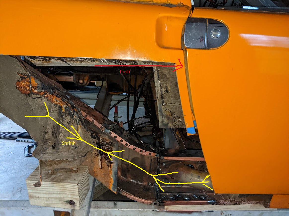

QUOTE(stoneman30hotmail @ Jan 3 2023, 05:42 PM) *
I would think welding in the wheel house shouldn't shrink the door gap.
You need to look very carefully at what’s going on and understand where the metal is being pulled by shrink.
See pic - yellow is the approximation of the sheet metal profile as viewed from above.
When you weld in the inner wheelhouse your going to end up with shrink that pulls in the direction of the red arrow. Because the sheet metal is anchored at the rear bulkhead you will get a pivot point marked by red dot.
Hopefully you can see from my crude drawing when the shrink occurs and pivots - the door gap will close. Especially so where the rear quarter is missing which would counteract it to some degree if it were there since that quarter panel would go into tension.

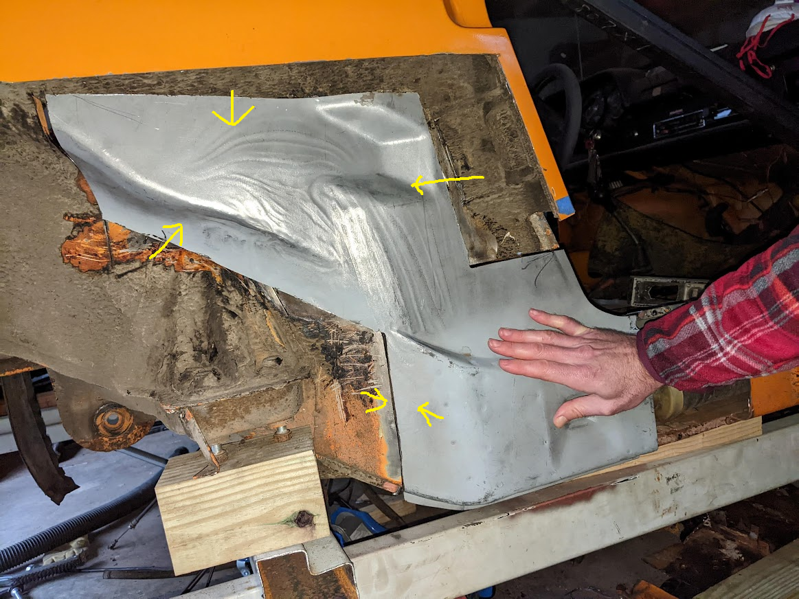

I think I understand what happened which I would show by this picture.
Sure, I will brace up with something before welding back the cut.
But then when I go to weld in this panel, won't it pull in from all sides? It's not obvious to me what the effect on the door gap would be. Do I need to worry? This guy did a larger section without door braces. https://www.youtube.com/watch?v=cqER3uEUG98

Superhawk996   This piece of sheet metal from Auto Atlanta is wha...   Nov 2 2022, 07:28 PM
stoneman30hotmail   This piece of sheet metal from Auto Atlanta is wh...   Nov 4 2022, 05:27 PM
Superhawk996   This piece of sheet metal from Auto Atlanta is w...   Nov 5 2022, 07:46 AM

Superhawk996   Your door braces are way to weak to be of any use ...   Jan 2 2023, 01:05 AM
stoneman30hotmail   Your door braces are way to weak to be of any use...   Jan 2 2023, 11:22 AM
bbrock   Your door braces are way to weak to be of any us...   Jan 2 2023, 12:23 PM
stoneman30hotmail   [quote name='stoneman30hotmail' post='3048791' da...   Jan 3 2023, 04:42 PM
Superhawk996   I think the issue wasn't so much the turnbu...   Jan 3 2023, 08:03 PM
Superhawk996   I would think welding in the wheel house shouldn...   Jan 3 2023, 08:18 PM
stoneman30hotmail   [quote name='stoneman30hotmail' post='3049028' da...   Jan 4 2023, 05:20 PM
bbrock   I think the issue wasn't so much the turnbuc...   Jan 4 2023, 08:55 AM

Superhawk996   I’ll apologise because my diagram is over simpli...   Jan 4 2023, 11:13 PM
