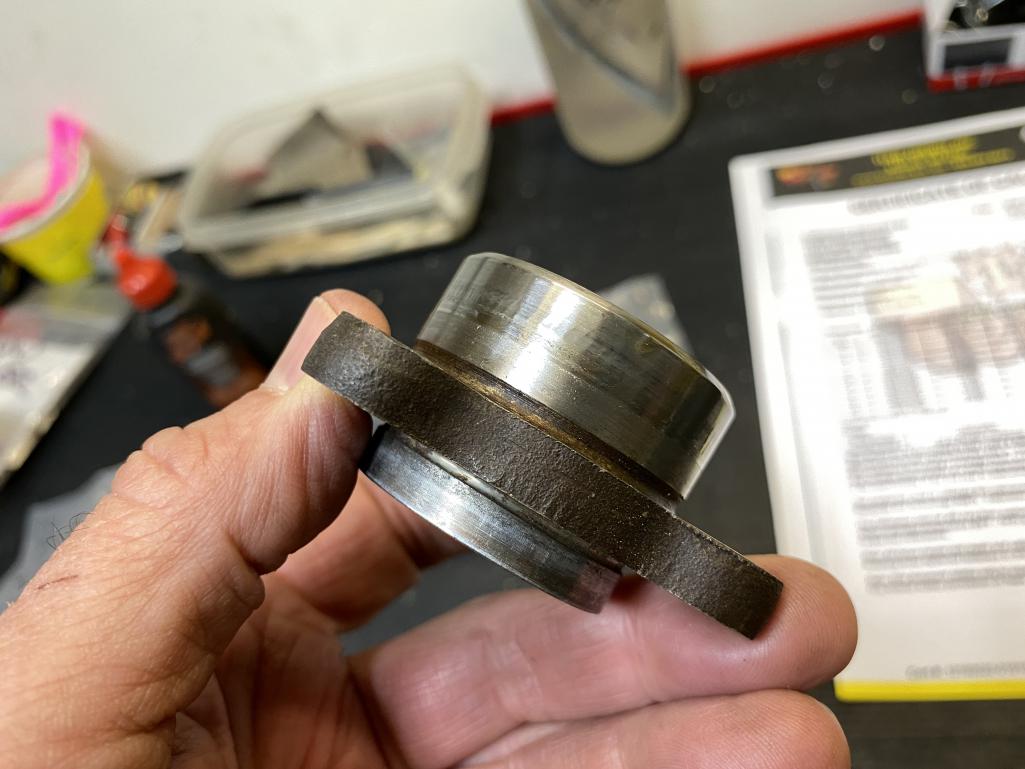

OK, more info. And in my quest for the right answer, I embrace all shame and reveal potential stupid. (IMG:style_emoticons/default/screwy.gif)
I took off the blower hub. The area behind the flange actually looks dry.

bkrantz   More thanks, everyone. During assembly, I used a ...   Jan 8 2023, 10:13 PM

bkrantz   Here's the cover off. No dramatic scoring. A...   Jan 9 2023, 08:25 PM
930cabman   Here's the cover off. No dramatic scoring. ...   Jan 10 2023, 12:26 PM
bkrantz   Here's the cover off. No dramatic scoring. ...   Jan 10 2023, 07:46 PM
