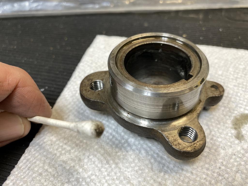

I confirmed this by running a Qtip around the base of the flange (on the engine side). A but of dirt but no oil. I assume if oil leaked past the front seal, this would be wet.
