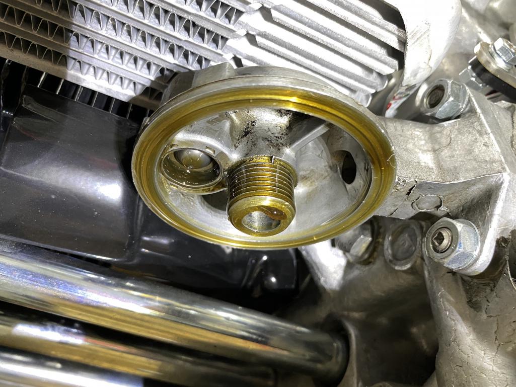

First stupid: when I went to unscrew the oil filter, it was barely tight. I mean, all it took to start unscrewing it was gentle finger grip.
