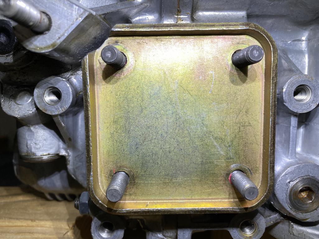

Member No.: 23,343
No leaks around the studs.

bkrantz   No obvious leak point around the pump cover.   Jan 9 2023, 08:22 PM
bkrantz   No leaks around the studs.   Jan 9 2023, 08:23 PM
bkrantz   Here's the cover off. No dramatic scoring. A...   Jan 9 2023, 08:25 PM
930cabman   Here's the cover off. No dramatic scoring. ...   Jan 10 2023, 12:26 PM
bkrantz   Here's the cover off. No dramatic scoring. ...   Jan 10 2023, 07:46 PM
