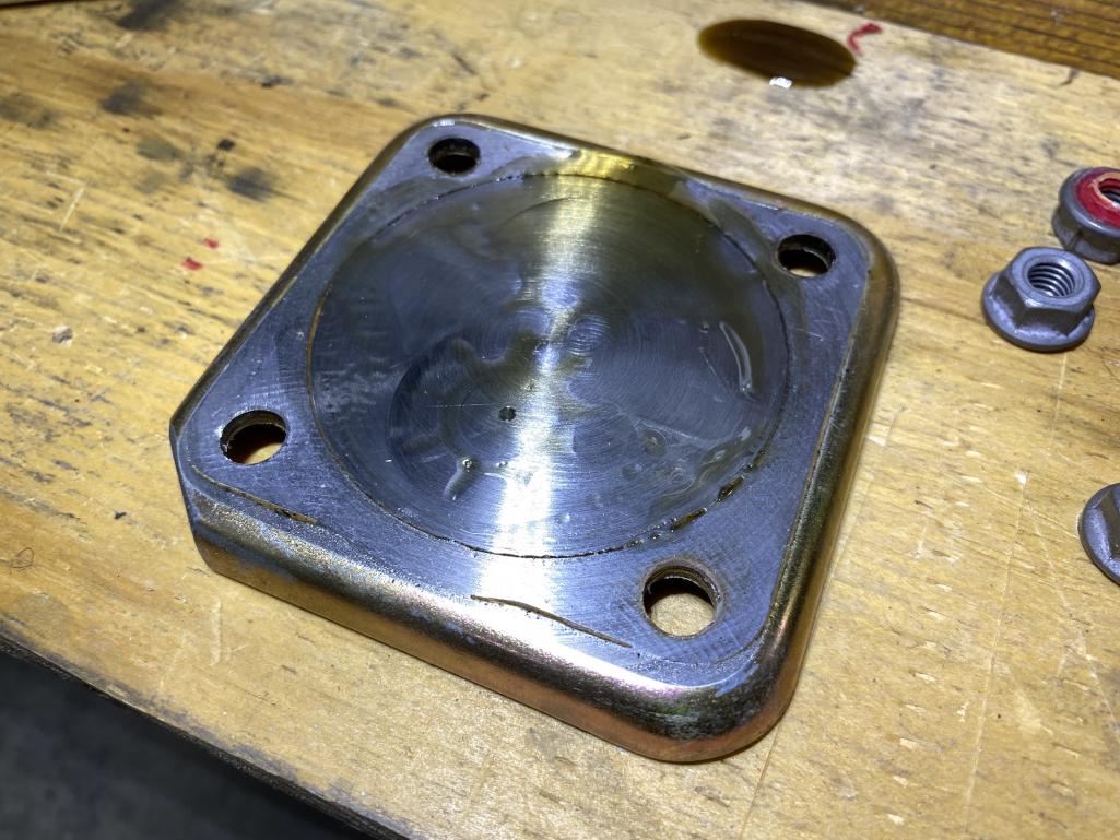

Here's the cover off. No dramatic scoring. Also no gasket. I am trying to remember if I did this on purpose. Stupid #2?

bkrantz   Here's the cover off. No dramatic scoring. A...   Jan 9 2023, 08:25 PM
930cabman   Here's the cover off. No dramatic scoring. ...   Jan 10 2023, 12:26 PM
bkrantz   Here's the cover off. No dramatic scoring. ...   Jan 10 2023, 07:46 PM

iankarr   I have the same oil pump cover and it was farrrr f...   Jan 9 2023, 08:50 PM
cassmcentee   Great news! Nothing crazy   Jan 9 2023, 09:15 PM
bkrantz   Great news! Nothing crazy But perhaps prett...   Jan 10 2023, 07:37 PM
r_towle   Is there a slot in the body and cover for an o-rin...   Jan 10 2023, 07:54 PM
bkrantz   Is there a slot in the body and cover for an o-ri...   Jan 11 2023, 08:22 PM
