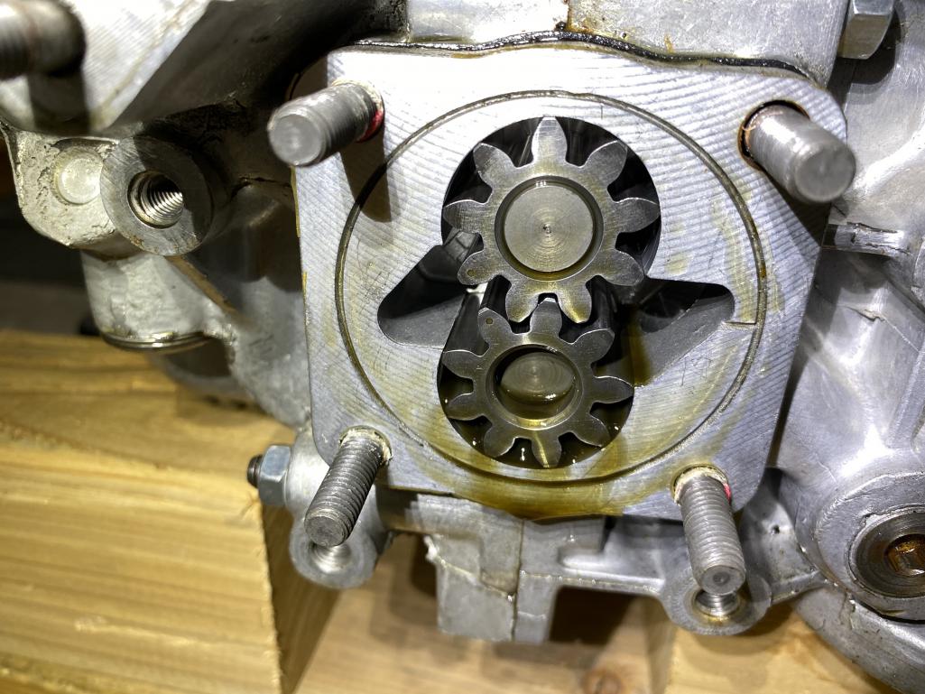

And the pump itself.
BTW, if I need to pull this, any clever way to extract it from the case?

bkrantz   And the pump itself. BTW, if I need to pull this,...   Jan 9 2023, 08:26 PM
iankarr   I have the same oil pump cover and it was farrrr f...   Jan 9 2023, 08:50 PM
cassmcentee   Great news! Nothing crazy   Jan 9 2023, 09:15 PM
bkrantz   Great news! Nothing crazy But perhaps prett...   Jan 10 2023, 07:37 PM
r_towle   Is there a slot in the body and cover for an o-rin...   Jan 10 2023, 07:54 PM
bkrantz   Is there a slot in the body and cover for an o-ri...   Jan 11 2023, 08:22 PM
nathanxnathan   The fan tends to suck in and redistribute oil all ...   Jan 11 2023, 11:44 PM
bkrantz   Thanks, everyone. Going back to my build thread.   Jan 14 2023, 09:26 PM
