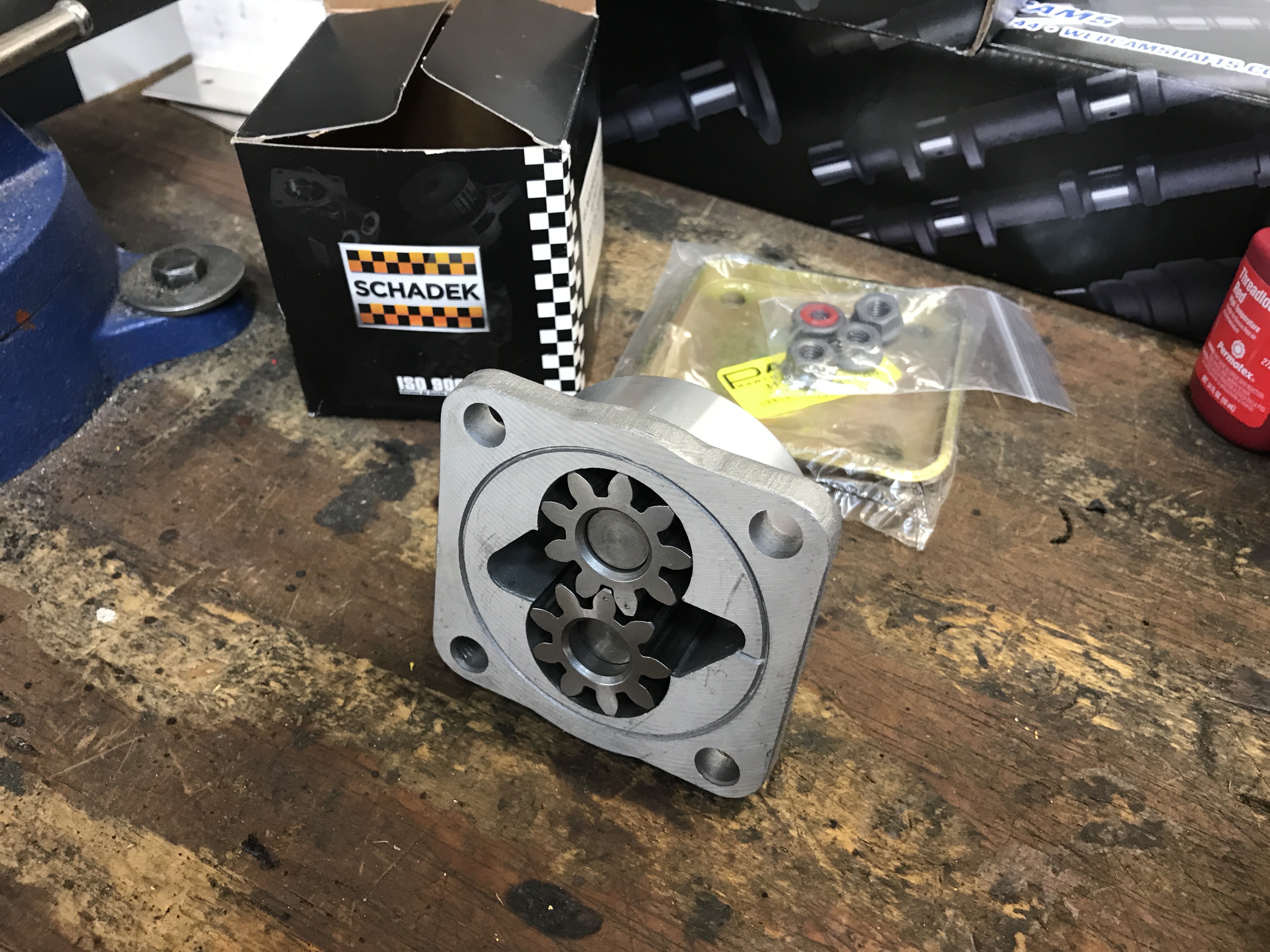

Here's the cover off. No dramatic scoring. Also no gasket. I am trying to remember if I did this on purpose. Stupid #2?

QUOTE(bkrantz @ Jan 9 2023, 09:25 PM) *
No gasket, but it does appear some residue of a sealer. When she was running how was the oil pressure, cold and hot? What pump is this?

QUOTE(930cabman @ Jan 10 2023, 11:26 AM) *
As best as I recall, I used a thin skim of case sealer (Loctite 574). The pump is a 26mm Shaded, modified (from Aircooled.net).
I only have a oil pressure warning light (something I plan to correct while the engine is out). All I can say is that the light went off quickly after both cold and hot starts, and never came on at idle.
