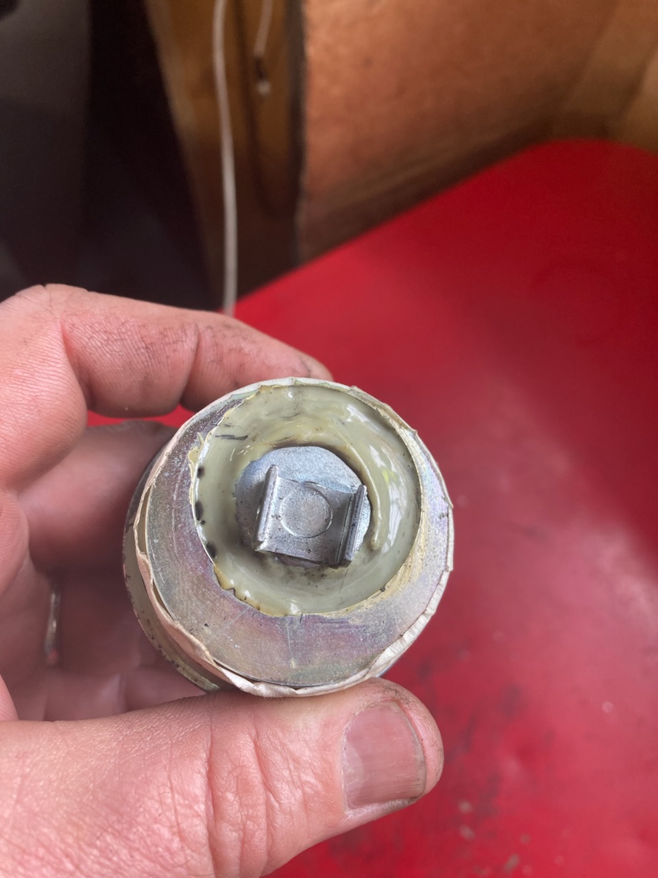

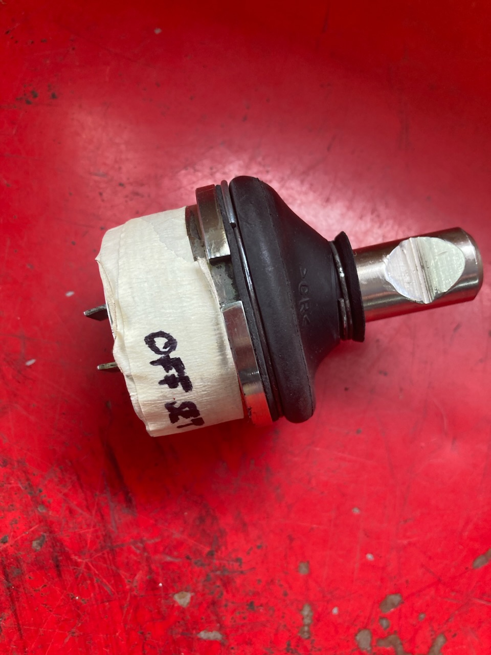

We’ve been running -2.25 front and -2.5 rear
I can’t remember what the ball joints come in
Vaguely want to say -1degrees
I never put these in as they were not needed
