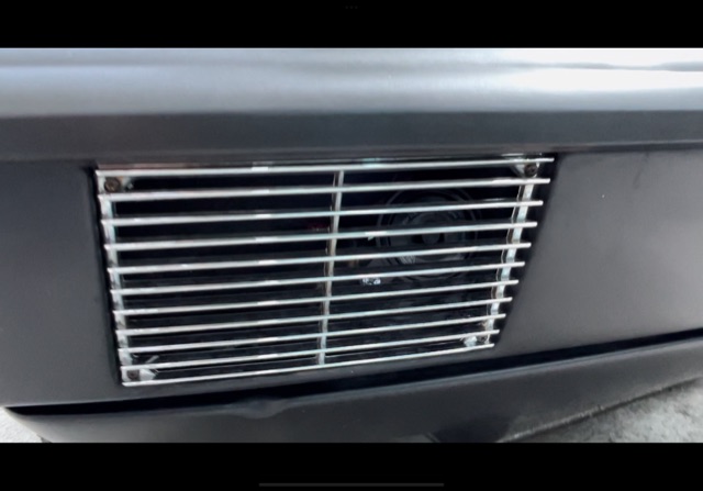

I like the clean look on mine,
but I am also into the large round lamps on some GT’s.
Is that a special bumper?

CCE   I like the clean look on mine, but I am also ...   Jan 31 2023, 12:06 PM
CCE   I like the clean look on mine, but I am also ...   Jan 31 2023, 12:26 PM
BillJ   Neat bumper. Definitely custom. I hope to do a ...   Jan 31 2023, 01:57 PM
