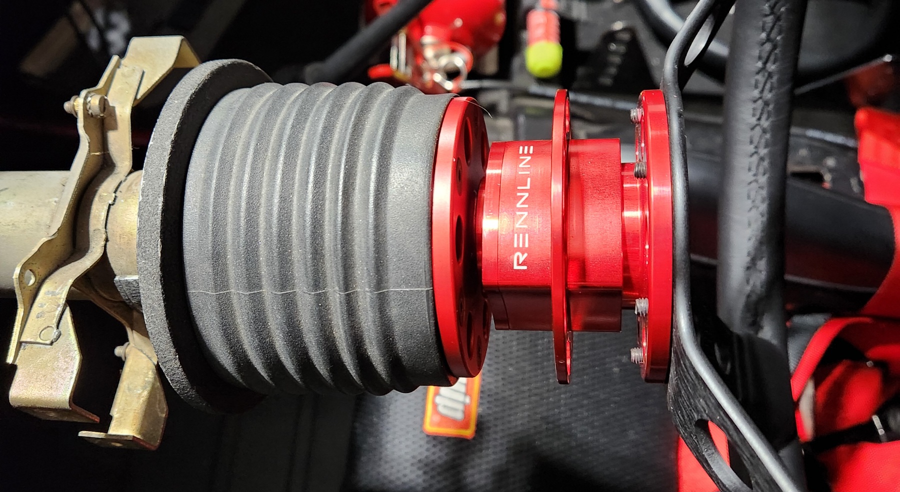

So a component that was really not that great was my quick release. It is the style that has two pulls on either side that allowed you to remove the wheel. At times it would bind and not easily release. Never had to escape the car but if that part doesn't release quickly when i really need it to then that is a safety issue. So i asked here and did some research and found i liked the design and operation of the rennline version. Only two downsides. 1. I cant use the porsche crest horn button unless i use what, to me, is an ugly retaining ring. So i may try and find a sticker to put there or leave as is. Not a biggie really.
Second issue is the now much longer assembly putting the steering wheel maybe an inch or more closer than i want. Does anyone know if a short hub adapter exists for the 914-6/911 steering shaft? Current one (it is the black accordian hub in the second picture) is 3" deep. Do they make.one that is shorter than that? 1" would be ideal. Current one is the collapsible version which i dont need with six point harness and race seats.

BillJ   So a component that was really not that great was ...   Feb 9 2023, 06:48 PM

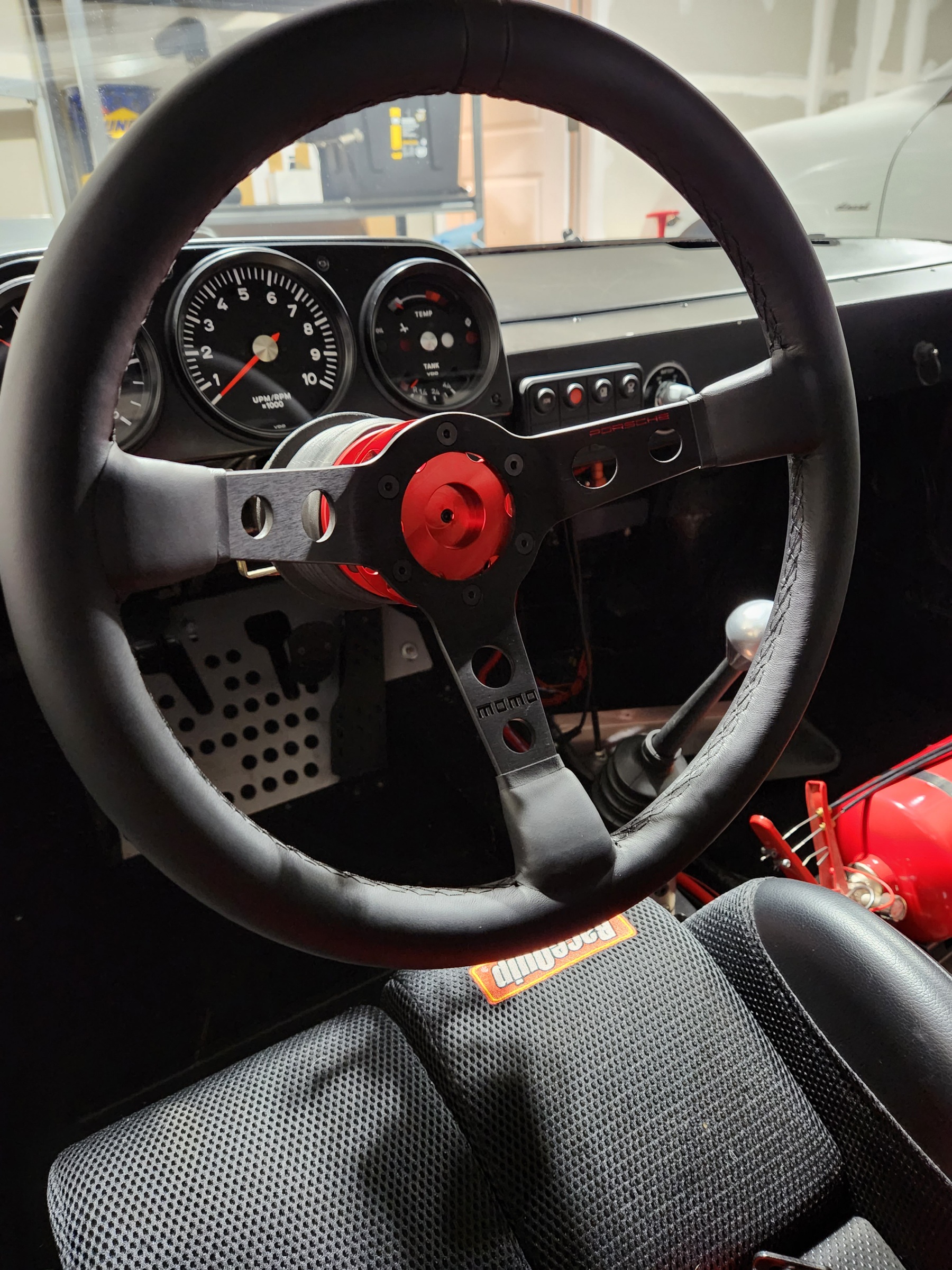

BillJ   Latest update is that i got new steering wheel an...   Feb 18 2023, 04:44 PM
Dion   This is coming along so nicely. That will be a nic...   Feb 18 2023, 04:53 PM
BillJ   This is coming along so nicely. That will be a ni...   Feb 19 2023, 03:47 AM
