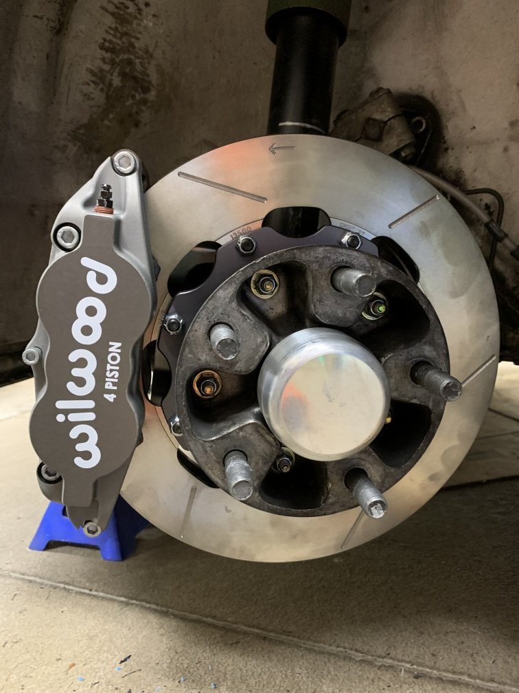

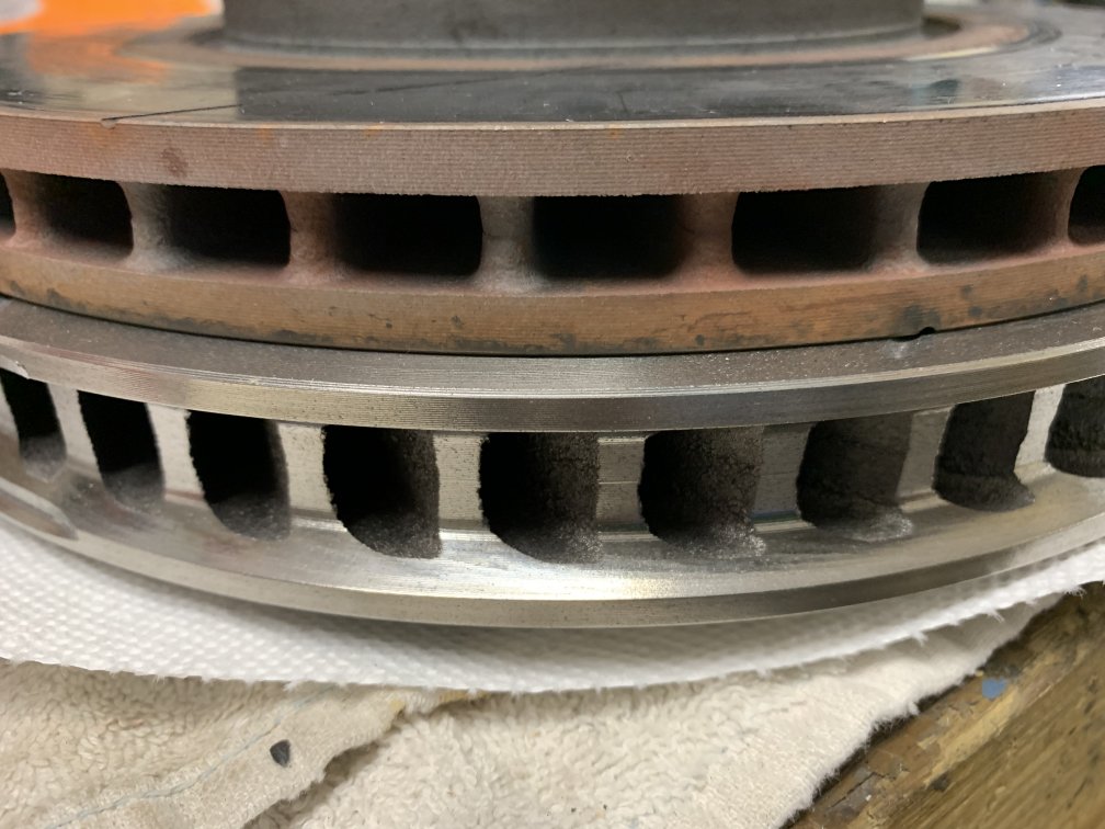

Well apparently I have not updated this thread in a while. The brakes got upgraded again to thicker and slightly larger diameter rotors just for giggles and to try and eliminate rotor cracking every 10 or so track days.
So yeah, those are a bit thicker at 1.21" vs the stock 911 SC discs at 0.81". The rotrs got mounted to hats I think I found in the Classifieds a while back that came from RSR here: https://www.rsrproducts.com/product-page/re...rotor-hats-pair
Then I designed the caliper brackets and gave Xometry.com a try. Only took a couple of weeks and was relatively inexpensive. To be honest, I rapid prototyped (3D printed) the brackets out of plastic first to verify the fit.
Brakes work great with no issues so far! ...but, more to come.
