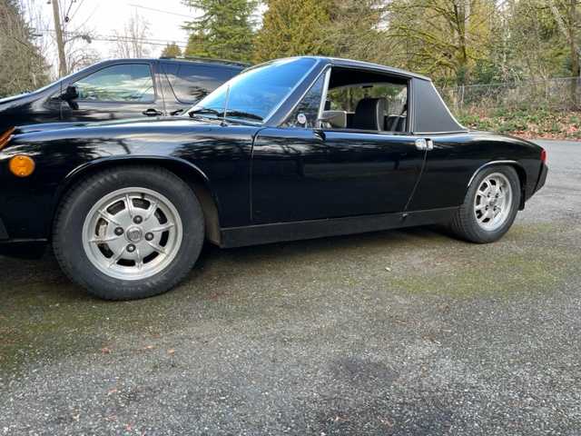

Looking to replace my 10 year old Eagle GTs. They are 195/60/15 but seems like only 195/65/15s are available now when looking briefly. They will go on 4 lug Mahles under stock fenders. Pretty sure I couldn't get 205s under the fenders without rolling them (not interested in doing so) because it's already pretty tight on one side.
What does the 914 brain trust recommend these days?

Quick update:
I decided to go with Vredestein Hitrac all seasons instead of the Yokohama Avid Ascend GTs as they were slightly better rated in all categories, especially grip and feel, and were pretty much the same price.
I have only put a few miles on them, but my impressions of them are very good so far at both low and high speeds. Small bump compliance is very good, and road noise seems minimal.
My only compliant is that they don't look very aggressive, but I guess can live with that.
195/65/15r
