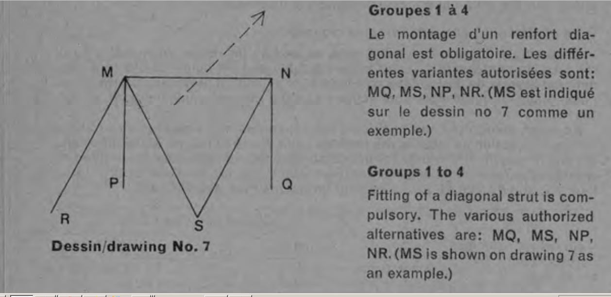

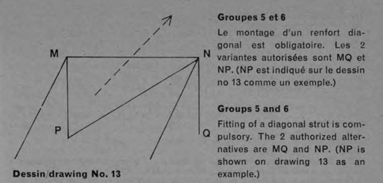

gms   The 914-6R (or 914-6 GT) was a race car made by Po...   Feb 14 2023, 09:07 PM
sixnotfour   https://pbase.com/9146gt/9146gt_factory_rac...rs_s...   Feb 15 2023, 08:46 PM
BillJ   I had front footwell protection added just recentl...   Feb 15 2023, 09:00 PM
gms   I found the Memo dated Feb 9 1971 1.3. Für den 9...   Feb 15 2023, 10:46 PM
gms   I found it! 1971 appendix J has the roll cage ...   Feb 16 2023, 03:54 PM
brant   But they only certified the car with a 2.0/6 IMSA...   Feb 16 2023, 04:44 PM
gms   @brant I am providing the documentation for the r...   Feb 16 2023, 05:17 PM
brant   Should work Anywhere that excepts imsa But I know...   Feb 16 2023, 05:54 PM
