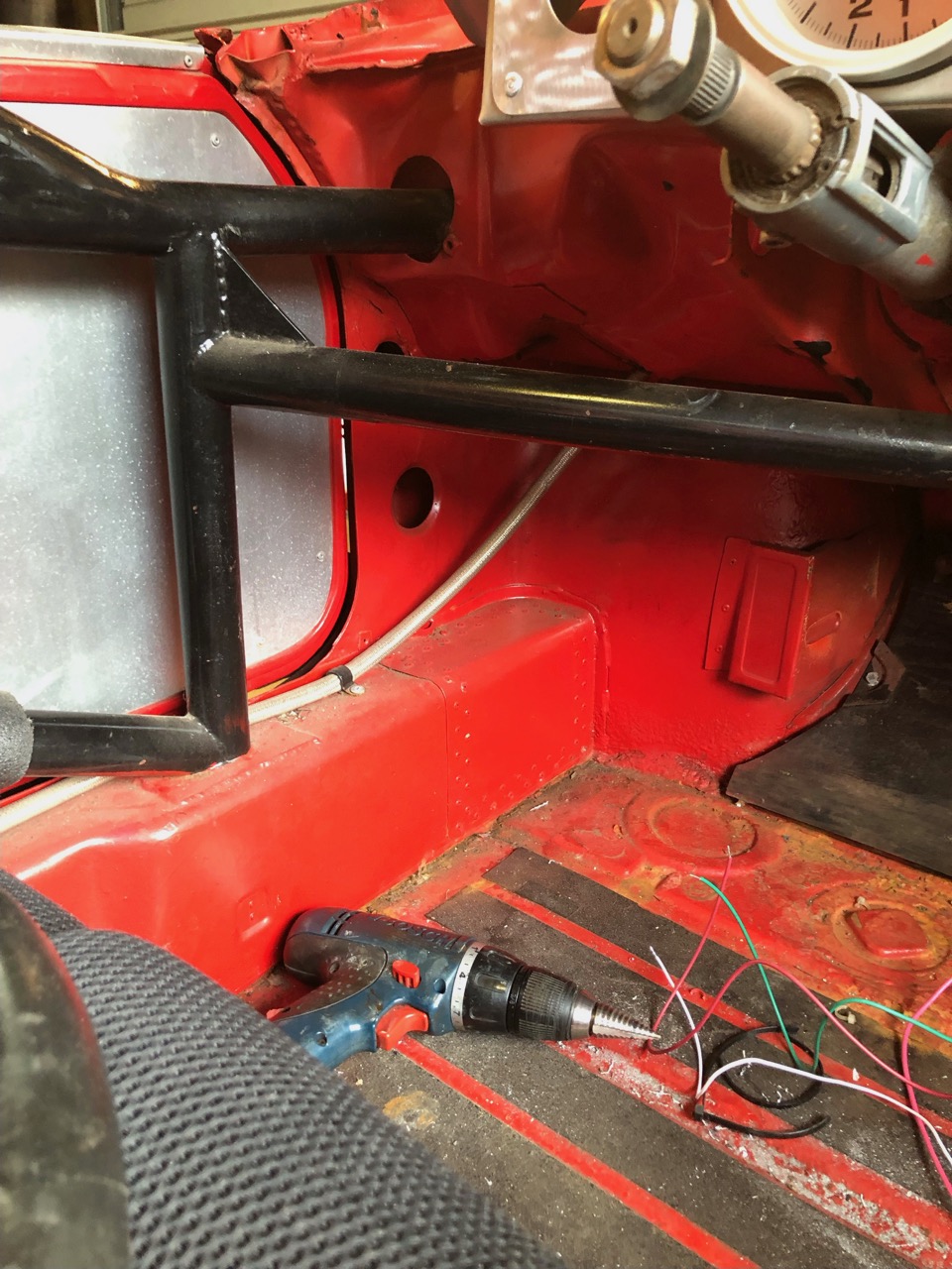

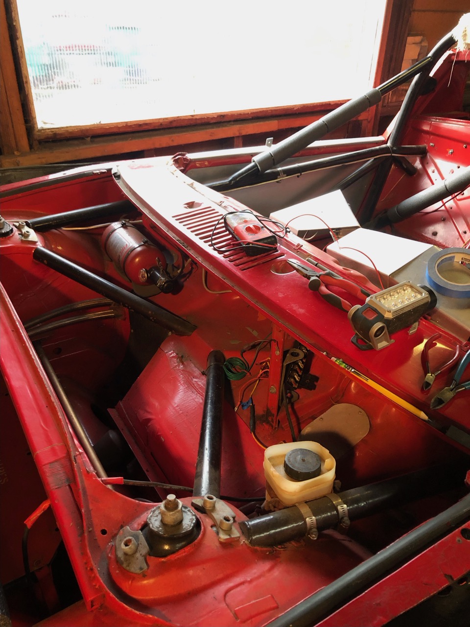

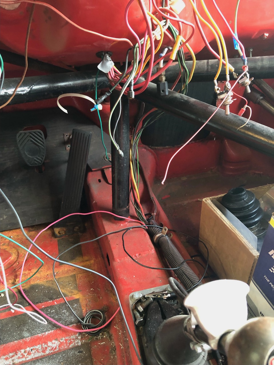

Here is how the front half is constructed. Please pardon the mess - I'm up to my elbows in a re-wiring project at the moment. There is a central vertical post mounted to the center tunnel that the diagonals from the front bars connect to, as well as diagonals from the side bars.
I have no idea who built this car. I've talked to a previous owner (2 owners ago) who said it came from Ohio. I don't know if it originated there. It was Orange at some point in it's life. Maybe from the factory. I don't know if it got color changed to red right off the bat, or if it happened later.
