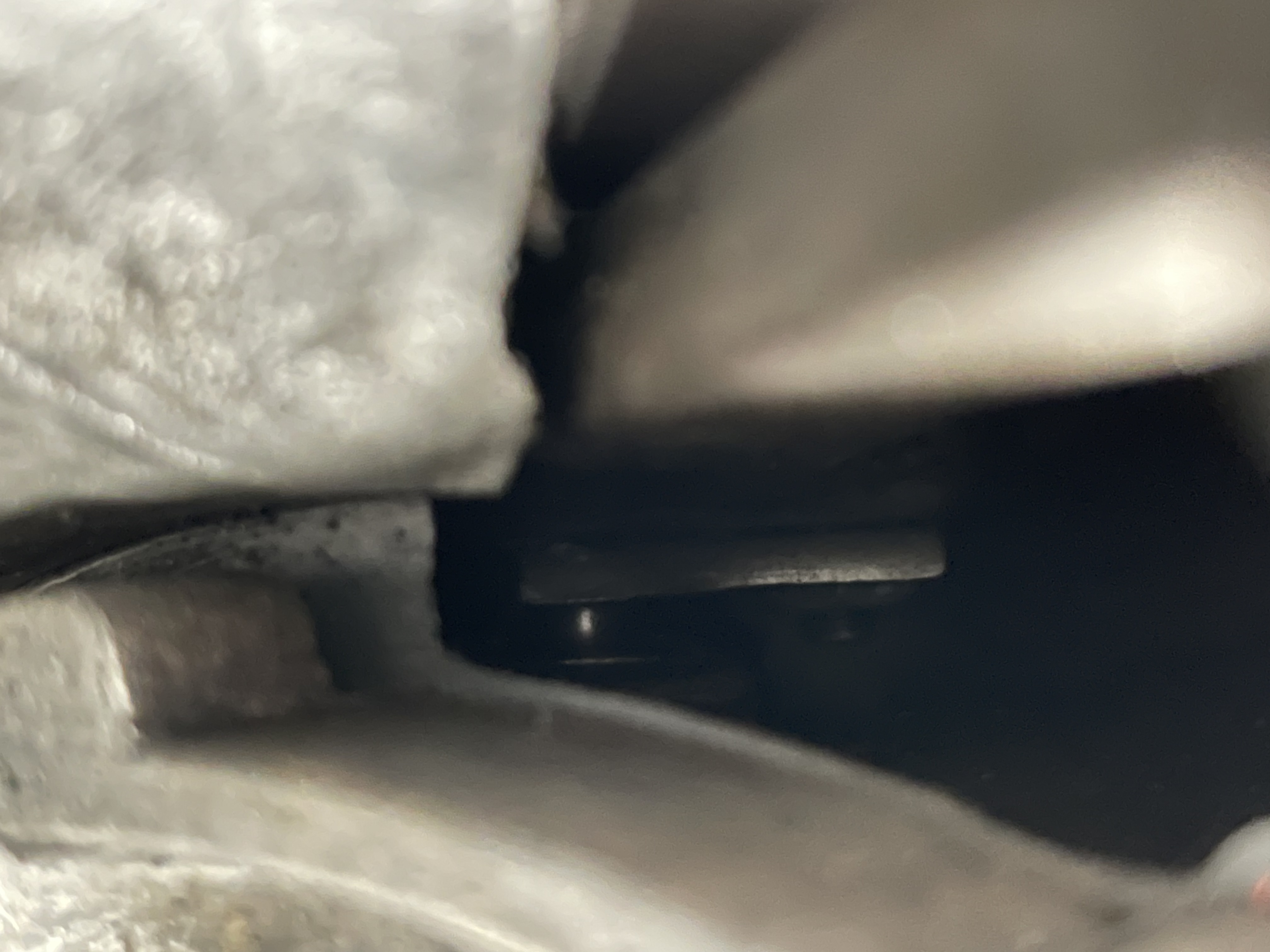

I look at the shift fork and it seems to be frozen or no play.

The clutch fork rests against the housing towards the front of the car and has about a 1/2” of play towards the back.
Cable back on and tightened and no difference. When clutch pedal is depressed the fork moves, but there is no difference in the feel. Role pin is in place.

Wew   This is a picture of the fork in the transmission....   Feb 17 2023, 12:35 PM

Steve   The clutch fork should be around half way in the o...   Feb 17 2023, 01:07 PM
