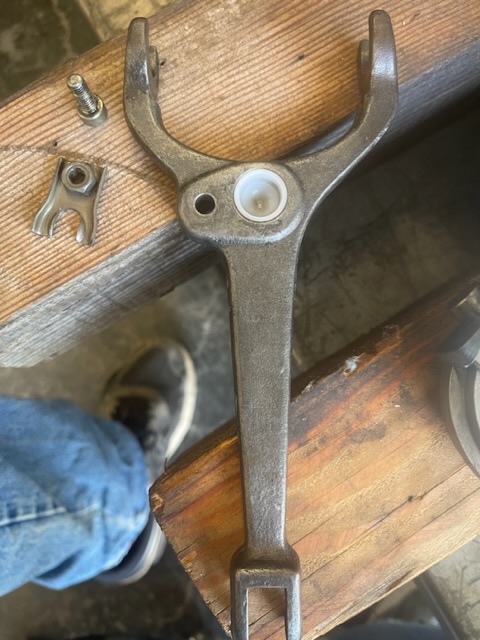

Wew   This is a picture of the fork in the transmission....   Feb 17 2023, 12:35 PM
Jack Standz   Some more guesses: clutch cable not properly adj...   Feb 17 2023, 12:47 PM

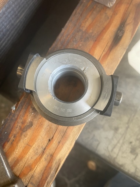

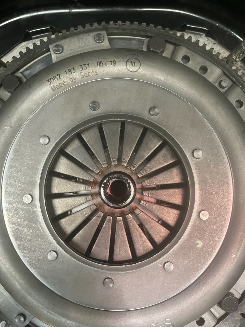

Wew   After reading Steve’s post I think I need to pul...   Feb 17 2023, 01:19 PM
Wew   After reading Steve’s post I think I need to pul...   Feb 17 2023, 01:36 PM
Wew   Attached are the photos   Feb 17 2023, 01:41 PM
Wew   Maybe my clutch disc is backwards? Can’t think...   Feb 17 2023, 02:28 PM
914werke   So think of the mechanics of the process. Push pe...   Feb 17 2023, 03:03 PM
Wew   Some pics after transmission drop   Feb 17 2023, 03:27 PM
Wew   Looks like clutch disc was on properly. Throw out ...   Feb 17 2023, 03:35 PM
Wew   Thanks for the input Rich. I don’t think my plas...   Feb 17 2023, 04:03 PM
theer   The wear marks on the pressure plate fingers look ...   Feb 17 2023, 04:18 PM
Geezer914   With the car sitting, and the engine not running, ...   Feb 17 2023, 05:34 PM
914werke   I don’t think my plastic bushing and ball we pr...   Feb 17 2023, 05:35 PM
