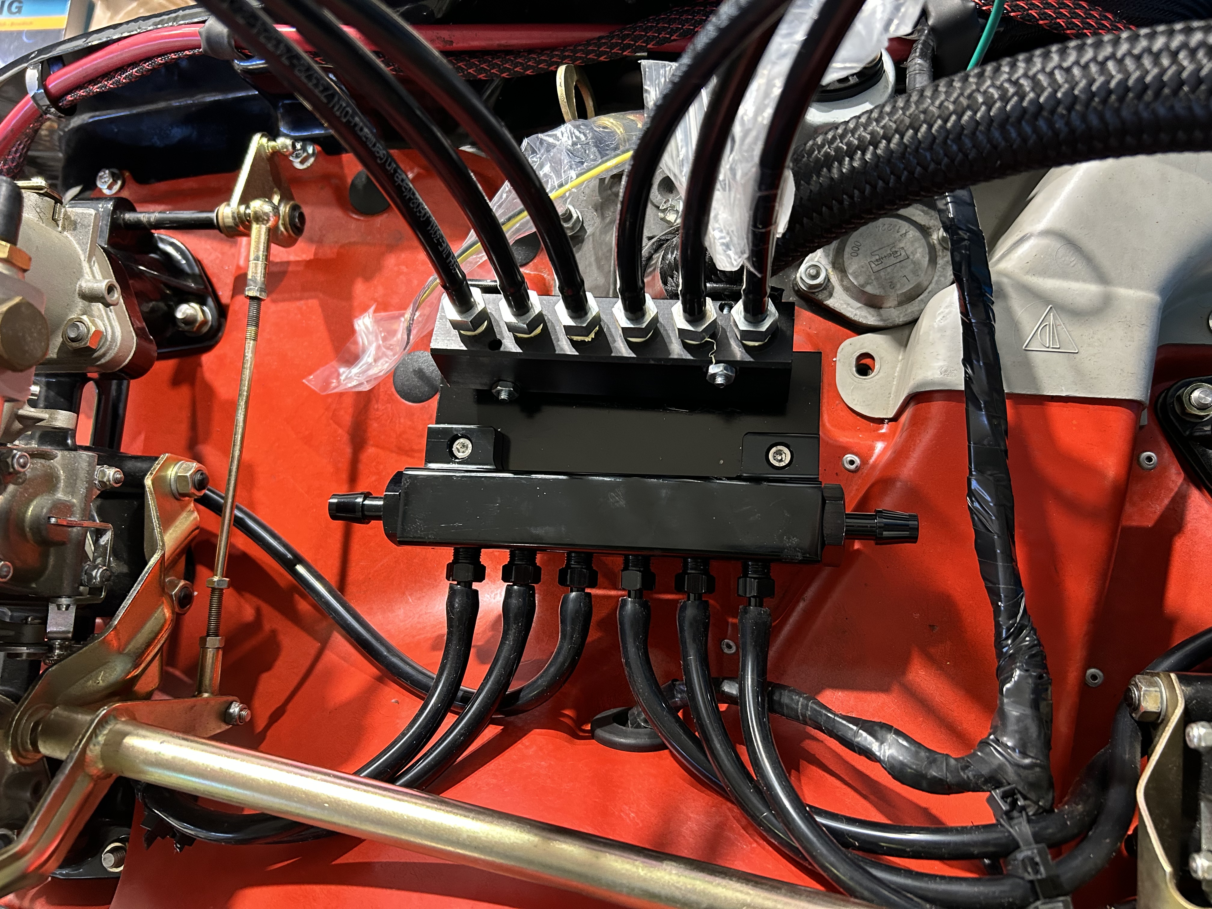

mb911   Vacuum fittings selected. I will have to drill and...   Jan 13 2023, 03:14 PM
gereed75   Vacuum fittings selected. I will have to drill an...   Jan 13 2023, 04:38 PM
mb911   [quote name='mb911' post='3050957' date='Jan 13 2...   Jan 14 2023, 05:54 AM

mb911   Went a different route on vacuum tubes. Drill .100...   Jan 16 2023, 04:42 PM
mb911   Equal length vacuum lines and manifold for a clean...   Feb 11 2023, 07:30 PM
technicalninja   You will need to check the map signal you get off ...   Feb 11 2023, 08:47 PM
mb911   You will need to check the map signal you get off...   Feb 12 2023, 05:44 AM

technicalninja   You do very nice work, Sir. What is the upper...   Feb 17 2023, 08:05 PM
mb911   You do very nice work, Sir. What is the uppe...   Feb 17 2023, 08:19 PM
JmuRiz   Cool fuel and vacuum block, right. Jpnovak’s se...   Feb 17 2023, 08:28 PM
mb911   Cool fuel and vacuum block, right. Jpnovak’s s...   Feb 18 2023, 06:38 AM
