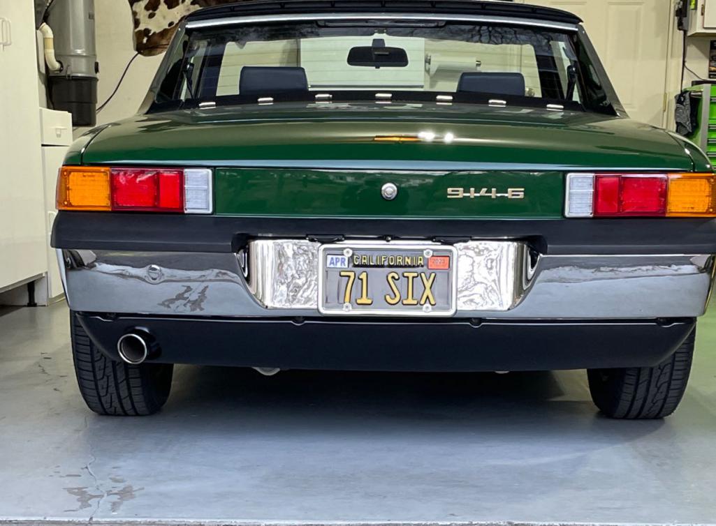

Can anyone share their experience with painting rockers or valance to match original? Looking at both color and texture. I have been through several forum threads. The recommendations range from BBQ grill paint to what seems like the most likely option of Wurth Underbody Stone Guard Black. it is $40 a can (3 can minimum), and they do have other products, so I'd like to avoid wasting money on trial and error if I can avoid it.
Our front valance and rockers appear to be original. I need to shoot the rear valance and would like to get as close to matching the other existing pieces as possible. Authenticity book only says: QUOTE These steel valances were painted to match the rocker panels and front valances. The rocker description simply says:QUOTE They were painted matte black... This is a 1970 914-6 with steel rear valance. ![]() Thank you. |

technicalninja I've used Dupli-color DE1634 "low gloss b... Feb 20 2023, 09:37 AM
dr914@autoatlanta.com we use wurth satin black trim paint. It gives a f... Feb 20 2023, 09:40 AM

Garland Here’s what I use, it comes out very close.
... Feb 20 2023, 10:58 AM

Is the pebbled appearance correct?
Our rockers d... Feb 20 2023, 01:24 PM
