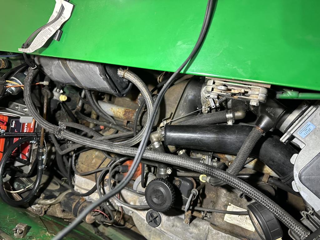

QUOTE(Van B @ Feb 23 2023, 07:41 PM) *
Definitely sounds like the AFM is doing stuff… but also, you can’t have that idle screw all the way down. You won’t idle like that. Put it two turns out and leave it there till you’re ready to set it up correctly.
Ref the video I made for you, remove the vac hose on the decel valve that runs from the side of the valve to the manifold. Block off the manifold and the port on the decel valve. Leave everything else connected for the moment.
Give it a start and lets see how it behaves.
Also, please post up your door placard so, we can confirm your mfg date.
Did as instructed I opened the idle adjustment screw 2 turns and after cranking a bit the engine started with a rough idle then stayed around 2000-2500 rpm. Again when gassed the rpm drops to almost stall but when I release the throttle it would idle back up to 2500 rpm. After 2 stabs of the throttle it finally stalled. I 've included the photos of the blocked off manifold T and side of Dcel valve along with the door label showing a Jan.1974 build date.

Van B   Definitely sounds like the AFM is doing stuff… b...   Feb 23 2023, 09:41 PM
tshih914   Definitely sounds like the AFM is doing stuff… ...   Feb 25 2023, 04:35 PM

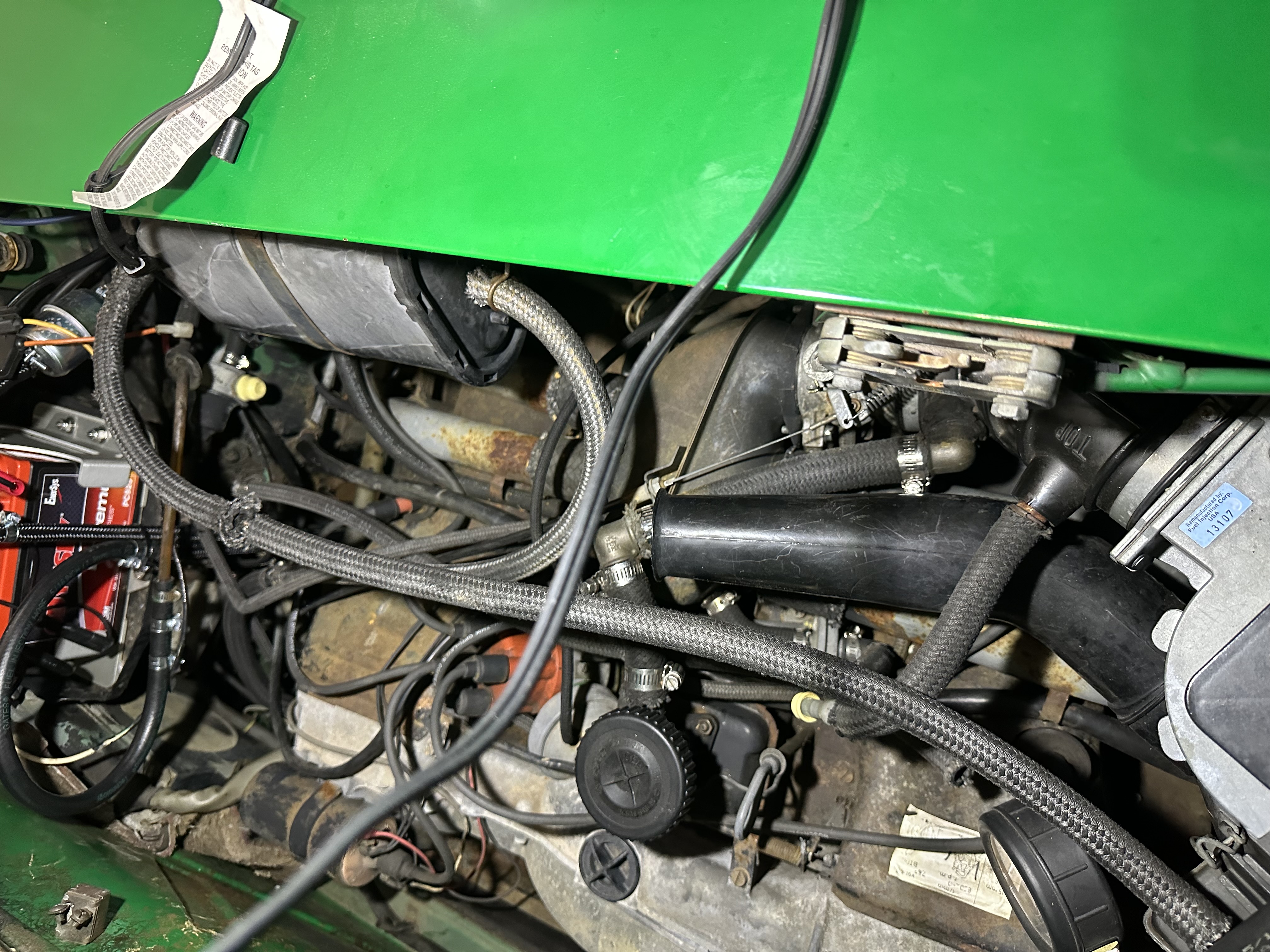

tshih914   Definitely sounds like the AFM is doing stuff…...   Feb 25 2023, 04:36 PM

Van B   @tshih914 The decel valve is on the other side. ...   Feb 25 2023, 06:45 PM
Van B   Yeah this is all wrong. You’ve got the wrong par...   Feb 25 2023, 06:49 PM
wonkipop   @Van B . i think he has got it right. he seems to...   Feb 25 2023, 07:22 PM
wonkipop   i think he has pulled this hose out and capped the...   Feb 25 2023, 07:26 PM
wonkipop   where i am going with my thinking @Van B is 1. ...   Feb 25 2023, 07:44 PM
Van B   Looks to me then like the decel valve is connected...   Feb 25 2023, 07:54 PM
wonkipop   @Van B . yes i noticed that kink in the small vac...   Feb 25 2023, 08:29 PM
wonkipop   i just watched your video @Van B . your decel is ...   Feb 25 2023, 08:56 PM
