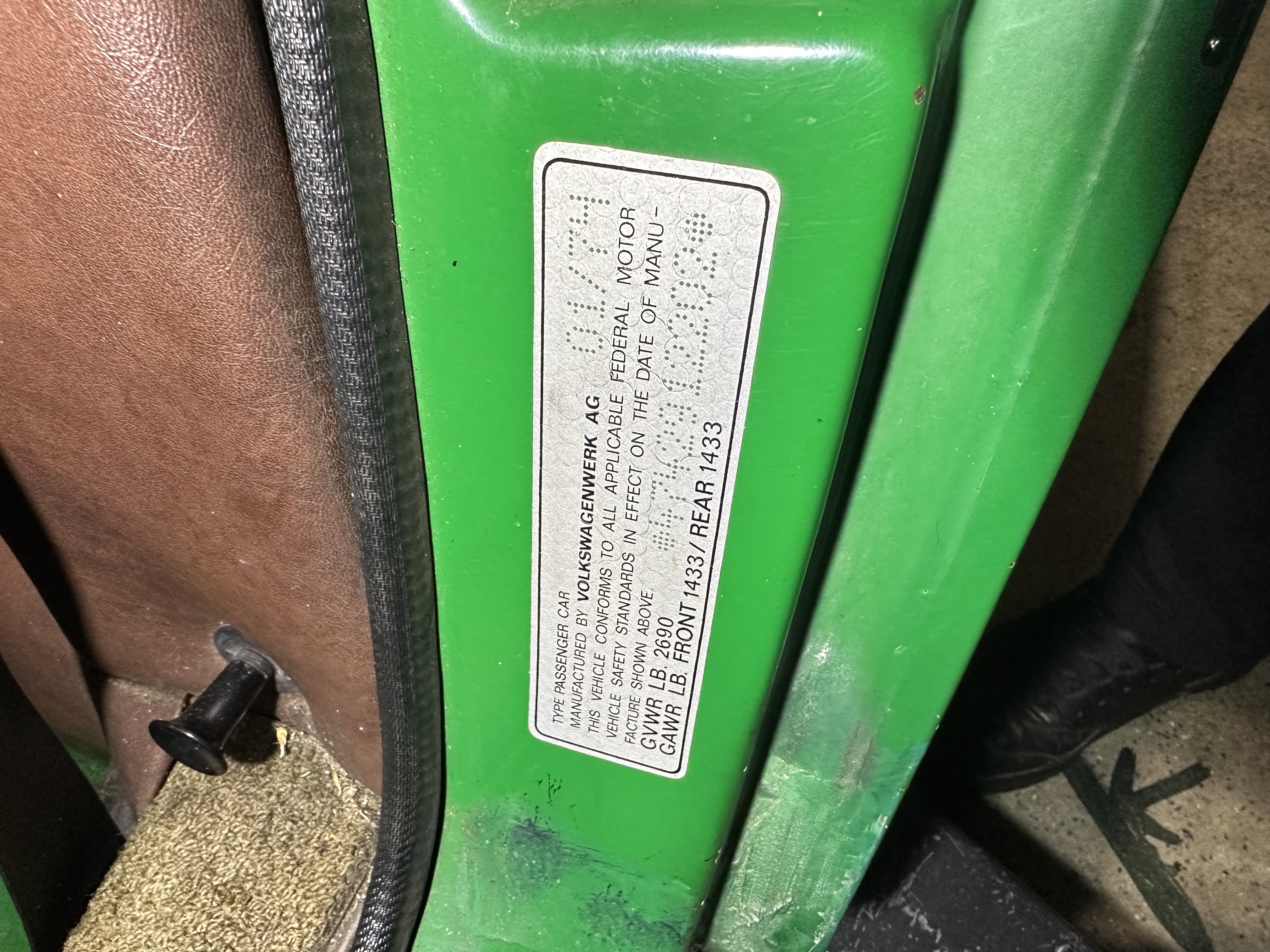

Also, please post up your door placard so, we can confirm your mfg date.
