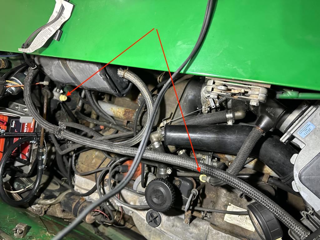

@Van B .
i think he has got it right.
he seems to have removed the hose between the decel valve and the Y junction.
the route for air to be drawn into the decel valve.
and he has capped the decel valve and the Y junction.
which means the decel valve can't draw air and the boot is sealed.
thats if i am reading his photo correctly?
i don't see any uncapped hoses to plenum in the photo.
so long as he has taken the hose out i understand he has it should be isolating the decel and stopping the air route and not leaving anything open.
