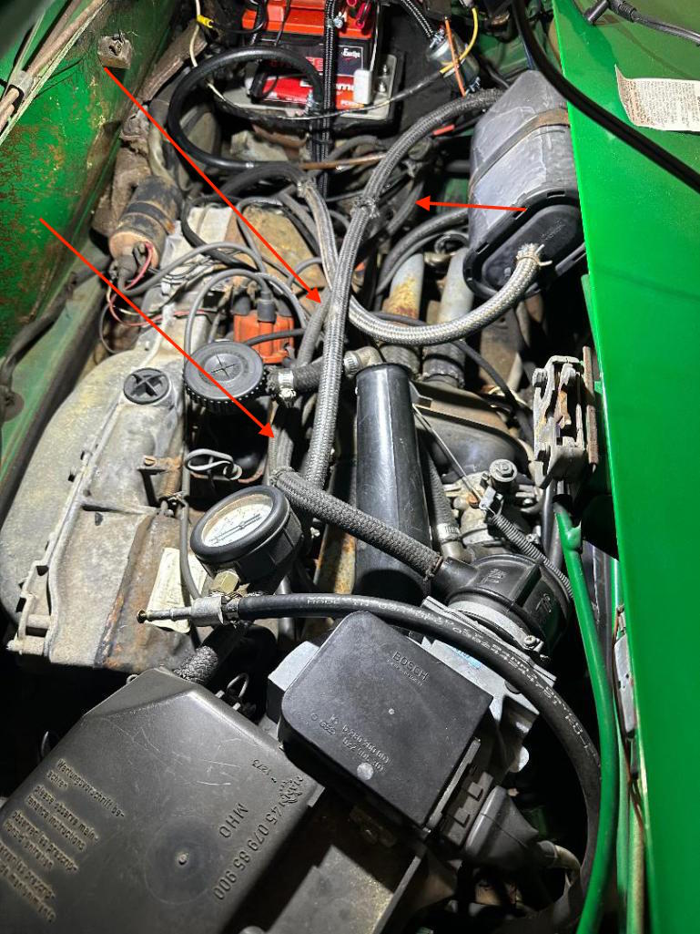

My 1.8L 914-4 with stock Bosch L?-Jetronic FI after being stored several years started to develop a hard to start problem. When finally started would stall when I give the gas pedal any input to raise the revs. I suspect there was some kind of intake air leak and while fiddling around had a backfire which blew the AF meter which I had Pelicanparts repaired. After replacing the fuel lines with the stainless ones from Tangerine Racing and flushing out the fuel system with Techron the engine started to run normally for a short time. Now the engine can be started and fast idles at 3000 rpm but again any input to rev up the engine results in stalling. The idle adjustment screw at the base of the throttle housing is fully closed. Any suggestions on how to fix?

i think he has pulled this hose out and capped the Y and decel at where it joined them.

wonkipop   @tshih914 we are getting somewhere. this time it...   Feb 25 2023, 05:56 PM
Van B   @tshih914 The decel valve is on the other side. ...   Feb 25 2023, 06:45 PM
Van B   Yeah this is all wrong. You’ve got the wrong par...   Feb 25 2023, 06:49 PM
wonkipop   @Van B . i think he has got it right. he seems to...   Feb 25 2023, 07:22 PM
wonkipop   i think he has pulled this hose out and capped the...   Feb 25 2023, 07:26 PM
wonkipop   where i am going with my thinking @Van B is 1. ...   Feb 25 2023, 07:44 PM
Van B   Looks to me then like the decel valve is connected...   Feb 25 2023, 07:54 PM
wonkipop   @Van B . yes i noticed that kink in the small vac...   Feb 25 2023, 08:29 PM
wonkipop   i just watched your video @Van B . your decel is ...   Feb 25 2023, 08:56 PM
