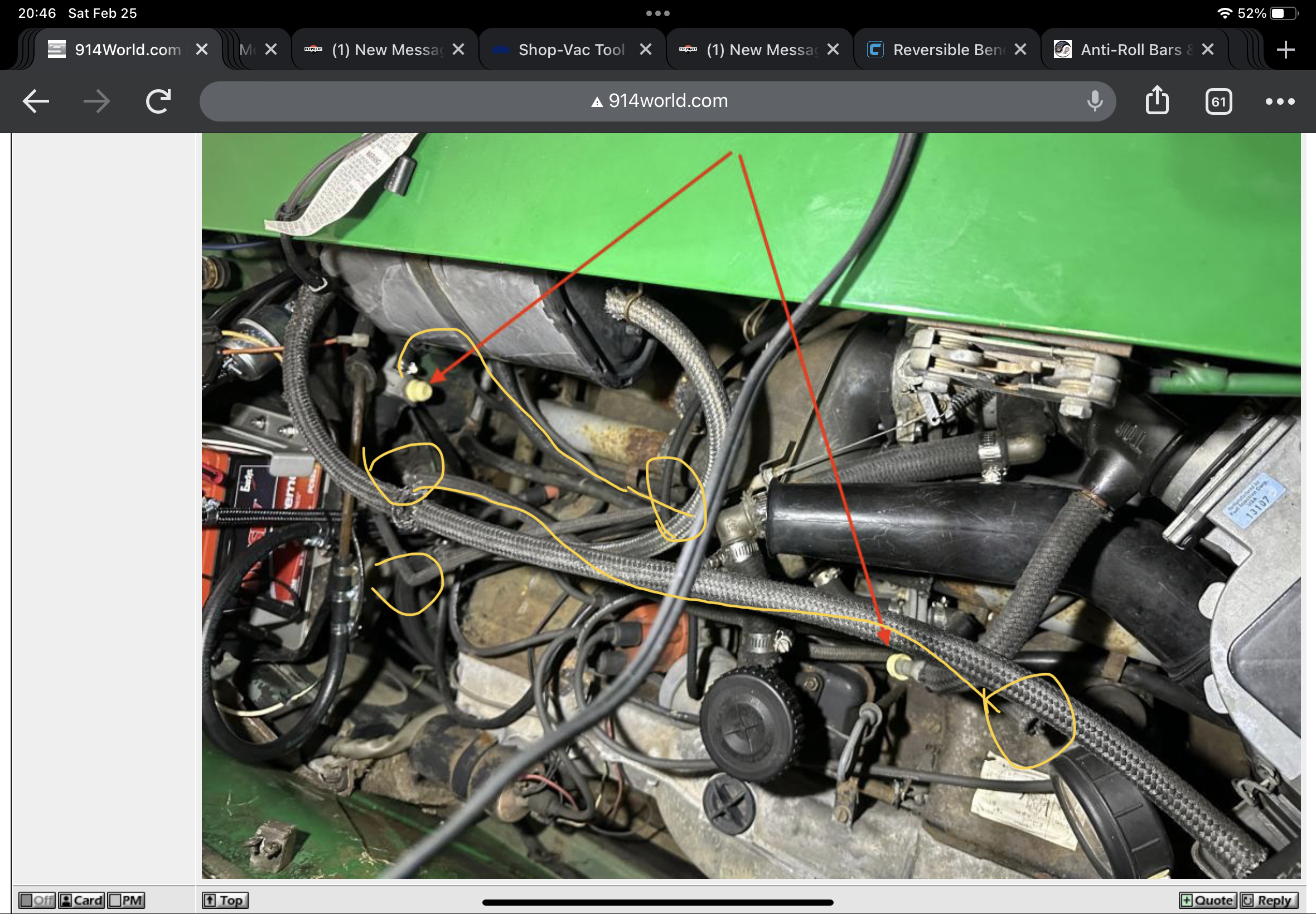

Looks to me then like the decel valve is connected opposite of mine and he hasn’t unplugged the decel line to the manifold but rather the bridge line from the intake to the valve?
See my mark ups below and tell me if I’m seeing it right?
Also, there is kink in the small line.
