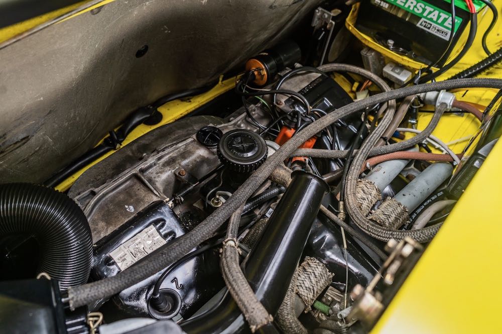

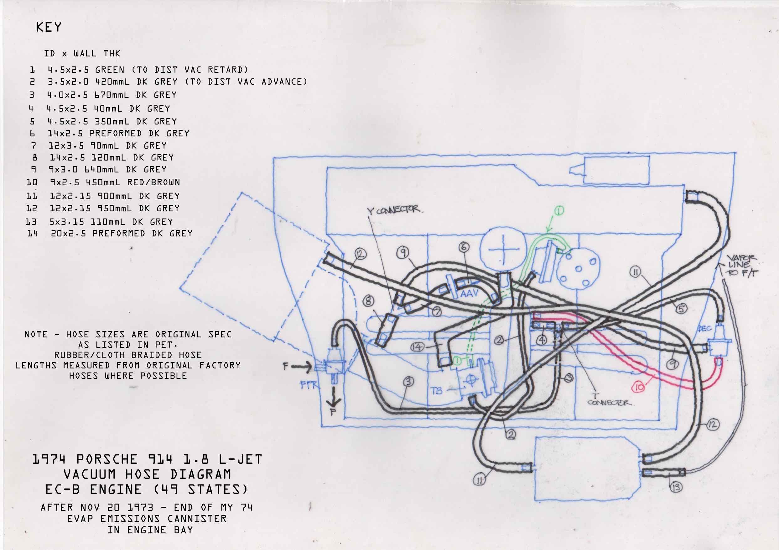

@Van B .
yes i noticed that kink in the small vac line to the decel.
i think he has only vac line 9 off. bridging line as you call it. and has capped off the connection points. so long as he only has that line off he is alright.
attached pic of set up for vac lines to decel.
but to be honest i don't think it matters which of the large lines you plug in either to side or end. the small line is opening the decel valve and letting the air through.
i think it can work either way, but before i say that i better double check.
(if yours is the other way around from diagram and attached photo it would tend to prove it does work either way, since your valve is operating beautifully anyway!! (IMG:style_emoticons/default/biggrin.gif) )
however most cars are rigged the way it is in the vac hose diagram.
attached example.
which appears to be how his is rigged.
EDIT
but you might be on to something there with the decel.
i can't really see in to his photo clearly enough.
@tshih914 , can you take a photo in close to the decel valve so we can see it really clearly.
