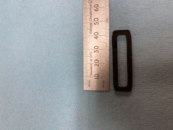

Here is the gasket on the AFM connector which wasn't allowing connector to seat home fully.
