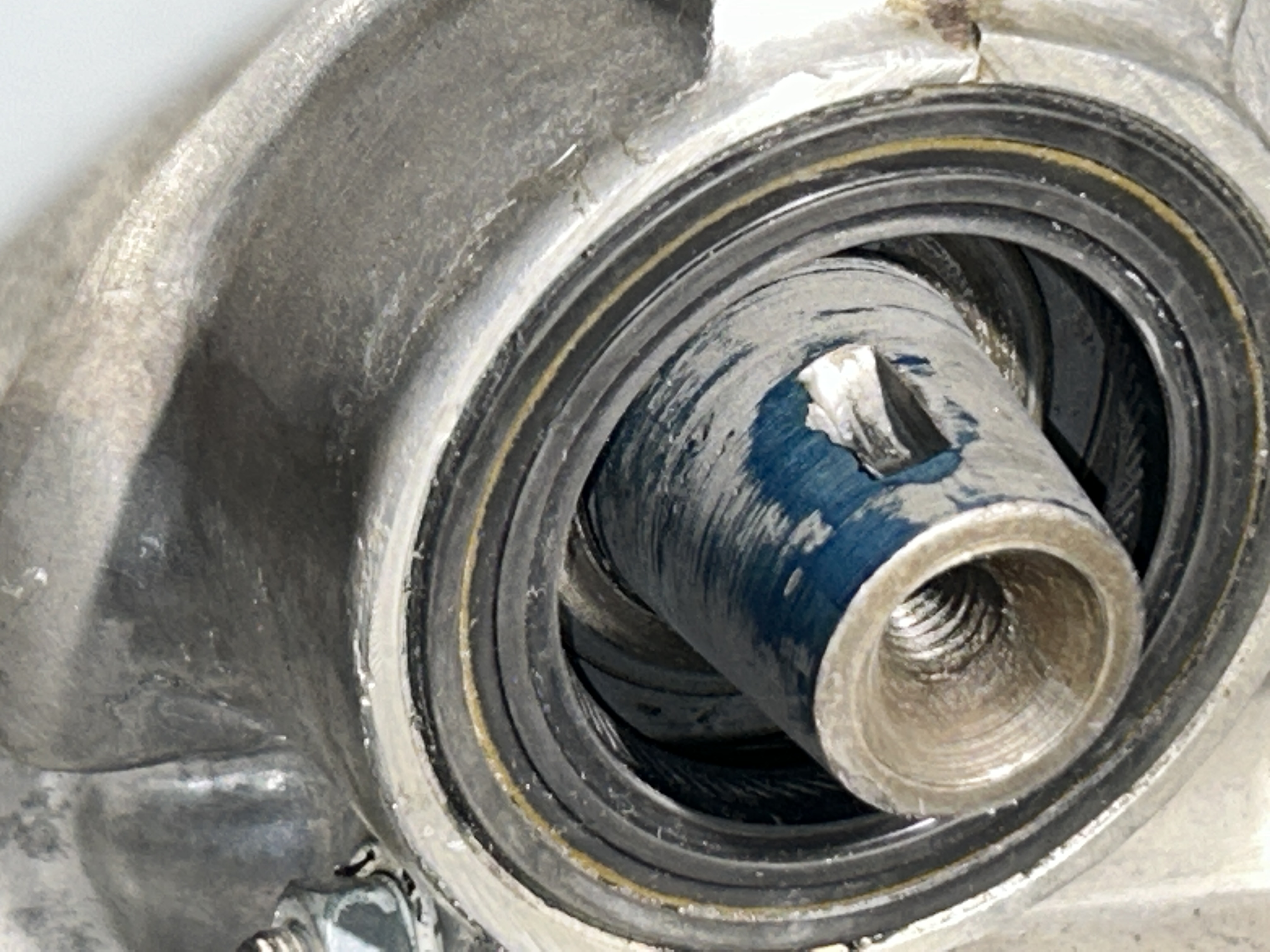

he called it MULTI-THOUSAND dollar prop, so yes.
Here is my Prussian Blue...
I wiped it on the hub and hand installed the hub. I slid it on with the key-way semi-aligned, At 1st I just rotated right and left a bit. Less blue transferred, but here in the same place.
Then I rotated the hub 360* and got this....

QUOTE(malcolm2 @ Feb 27 2023, 07:53 AM) *
Getting there but you still have a long way to go as you have a raised area around the keyway,I would get a guality flat file and just carefully work it down then redo your lapping and see what you get,don't be afraid to use course lapping paste as I will give you a good indicator when you blue it again ,then you can go finer if good result.
Your final result will be if the hub can be tapped on with a socket and will be hard to pop back off the taper you need this as it won't be an issue later .
Remove the old seal so you can see better whats going on and keep rotating the crank,cheers.
