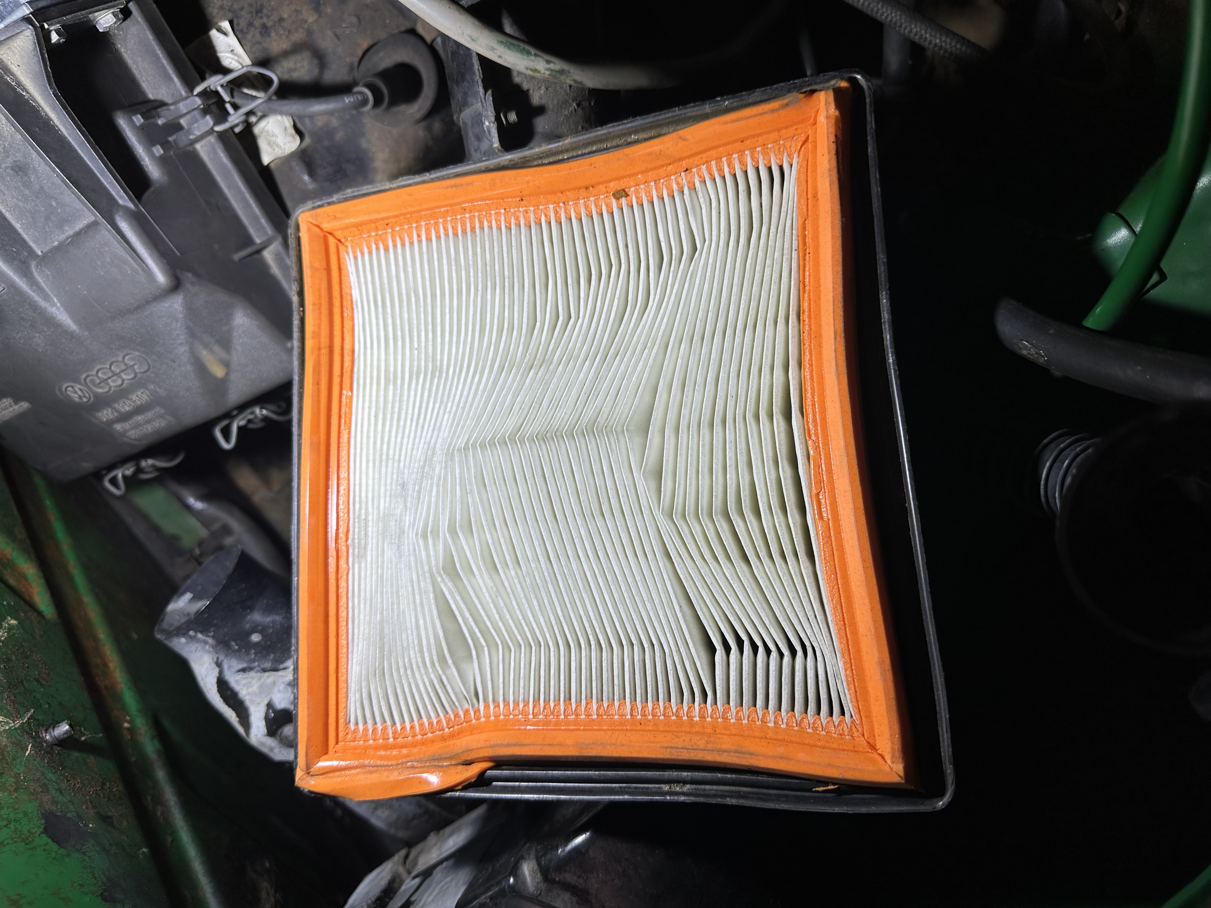

Well the new boot and throttle gasket was delivered yesterday so I replaced the old today. I also noticed that my air filter was badly mangled at one edge but after I replaced it with new one no difference in engine response to gassing it(stalls).
