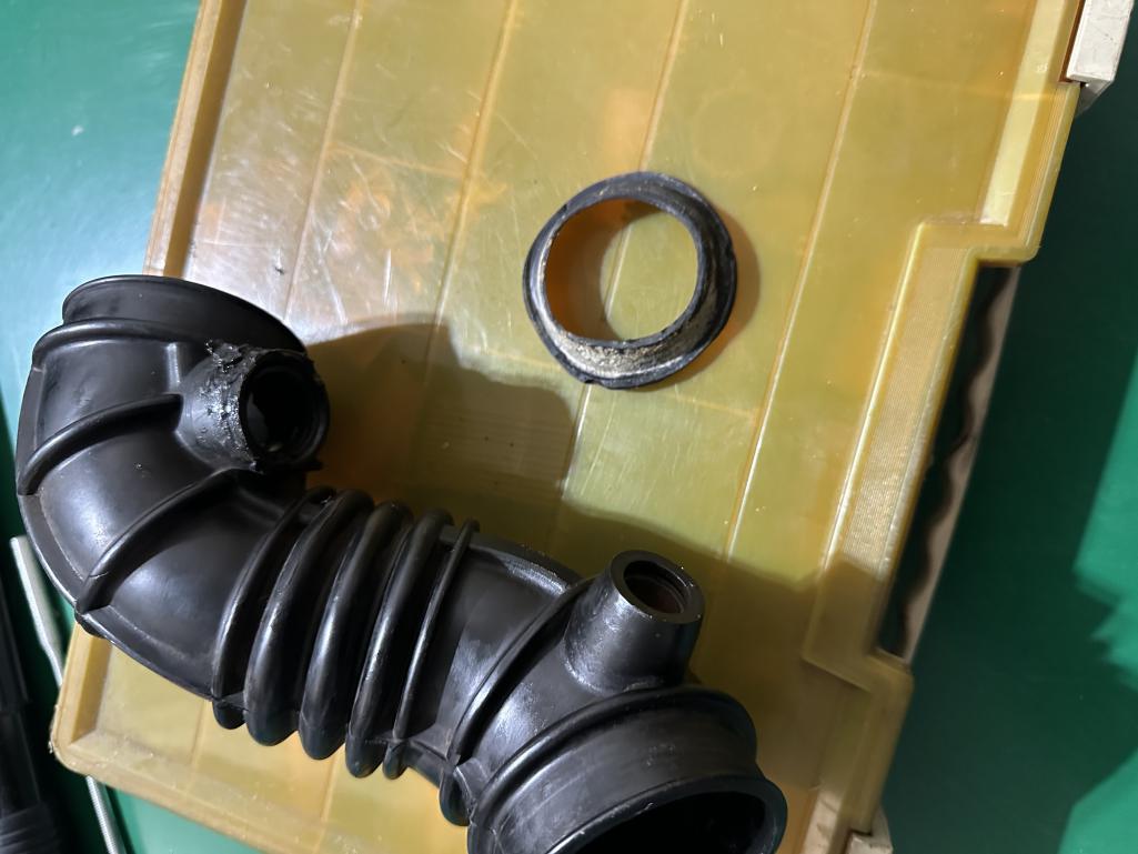

Well the new boot and throttle gasket was delivered yesterday so I replaced the old today. I also noticed that my air filter was badly mangled at one edge but after I replaced it with new one no difference in engine response to gassing it(stalls).

When after many attempts to fire up the engine starts to idle at 3000rpm. I pinched off the Aux air valve and the rpm dropped to 1200, when I release the clamp the idle goes back to 3000. When I put my hand over the snorkel I feel no air moving into the AFM (its adjustment screw is covered by a rubber plug to discourage tampering after it was rebuilt.

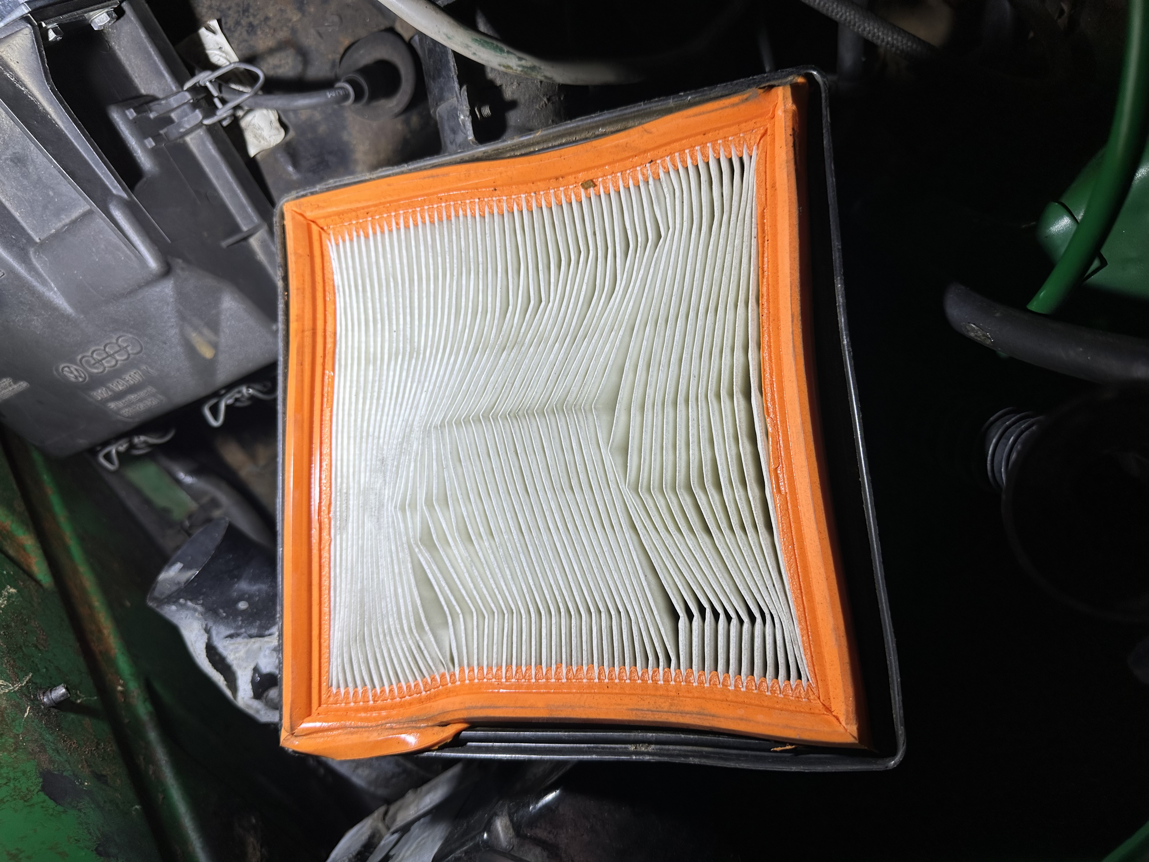

tshih914   [quote name='wonkipop' post='3062180' date='Mar 2...   Mar 3 2023, 10:12 PM
tshih914   [quote name='wonkipop' post='3062180' date='Mar ...   Mar 3 2023, 10:13 PM
tshih914   [quote name='tshih914' post='3062427' date='Mar 3...   Mar 3 2023, 10:18 PM
Van B   When you pinch the AAV hose, and the rpm drops to ...   Mar 3 2023, 10:42 PM
Van B   One other thing, I’m not understanding how you j...   Mar 3 2023, 10:43 PM
