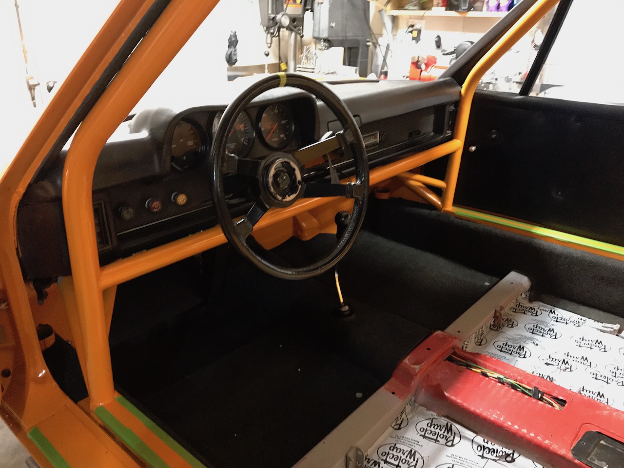

I planed to go vintage racing...but just got to old. I will return to the track for DE's. My cage to suspension points is very similar to Charles. Make chassis very stiff. Best, MarkAttached Image Attached ImageAttached Image

BillJ   Not sure if i am a fan of the kinked bar in the fr...   Mar 6 2023, 12:07 PM
brant   Not sure if the cage would pass tech under SCCA ru...   Mar 6 2023, 12:47 PM
mlindner   I agree, the cage is 30 years old. It also had dia...   Mar 6 2023, 01:28 PM
ChrisFoley   That dash bar is low enough to be a knee breaker i...   Mar 8 2023, 04:28 AM
BillJ   I redid mine for that very reason. Think you dont...   Mar 8 2023, 11:16 AM
brant   A buddy of mine broke his knee cap in a similar ba...   Mar 9 2023, 12:33 PM
