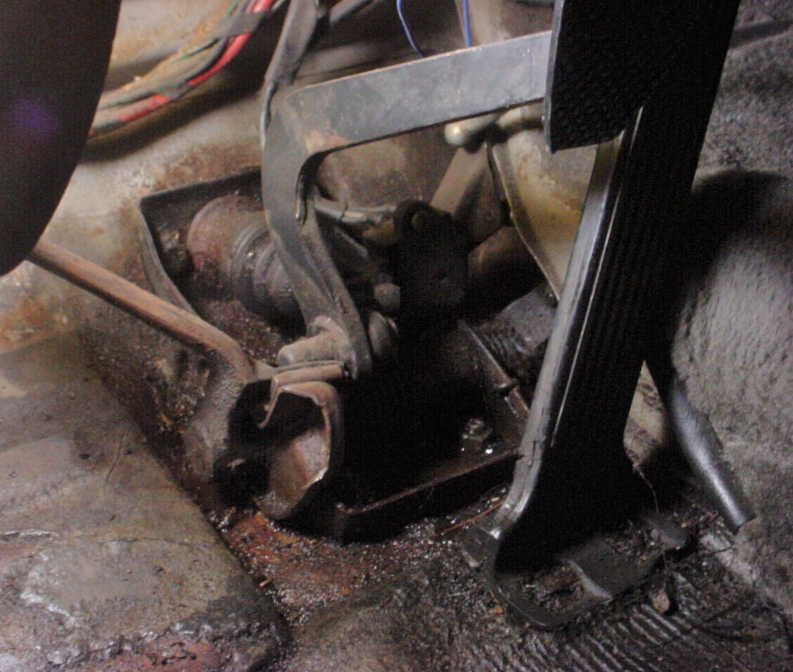

I am replacing the calipers on my car. After pumping the old fluid out, we realized the soft lines needed repair (they were fine before). Now, there is a link under the car that appears to be coming from the master cylinder:
The dark areas are wet with brake fluid.
Here is a closeup of the master cylinder. The dark areas are wet. The only spot that is not wet (yet) is the lighter area on the lower left:
I have checked the reservoir at the top and it is fine. The fluid is coming from somewhere down here.
Please advise!
Thanks!
-Jeff
914 RZ-1
post Mar 11 2023, 11:41 AM
Porsche Padawan
Posts: 684
Joined: 17-December 14
From: Santa Clarita, CA
Member No.: 18,230
Here's a view under the carpet. It's wet. There's a bit of fluid coming out of the rubber cap behind the pedals also.
Are the 19mm master cylinders a good replacement or should I stick with the 17mm? Pelican has FTE and ATE brands. Which is better?
How hard is it to rebuild these with new seals?

Craigers17   Just to double check things, if you have carpet, I...   Mar 11 2023, 11:34 AM
914 RZ-1   Here's a view under the carpet. It's wet. ...   Mar 11 2023, 11:41 AM
brant   You need to pull the pedal board Then the rubber s...   Mar 11 2023, 11:42 AM
Craigers17   Based on that last picture, at a bare minimum, I d...   Mar 11 2023, 11:52 AM
Mikey914   1st, yank this out and clean up the fluid. I'd...   Mar 11 2023, 12:02 PM
914 RZ-1   1st, yank this out and clean up the fluid. I...   Mar 11 2023, 05:26 PM
930cabman   Time for a new Master Cylinder   Mar 11 2023, 02:45 PM
914 RZ-1   Yeah, I'm gonna clean this all up: pedal clust...   Mar 11 2023, 02:51 PM
bdstone914   Yeah, I'm gonna clean this all up: pedal clus...   Mar 11 2023, 03:38 PM
flyer86d   Replace the master cylinder. If your pedal cluster...   Mar 11 2023, 03:23 PM
troth   This was the result of a mc leak on my 911. I w...   Mar 11 2023, 03:26 PM
914 RZ-1   How do I get the lines on the top detached from th...   Mar 11 2023, 05:08 PM
Craigers17   You can just pull the steel parts of those reservo...   Mar 11 2023, 06:51 PM
914 RZ-1   You can just pull the steel parts of those reserv...   Mar 11 2023, 10:02 PM
Garland   Don’t forget the MC washers! “914 World ...   Mar 11 2023, 07:41 PM
76-914   A nickel to a donut your MC is toast. It will be m...   Mar 11 2023, 07:51 PM
914 RZ-1   I got it off. I just needed to pull it out a littl...   Mar 11 2023, 08:46 PM
bkrantz   What I like to do, for removing and installing the...   Mar 11 2023, 09:09 PM
914 RZ-1   What I like to do, for removing and installing th...   Mar 11 2023, 09:42 PM
Mikey914   Sorry was working in the shop today. Sounds like y...   Mar 11 2023, 09:52 PM
914 RZ-1   Which hoses from the reservoir go where? I've ...   Mar 11 2023, 09:59 PM
Mikey914   Which hoses from the reservoir go where? I've...   Mar 12 2023, 12:40 AM
