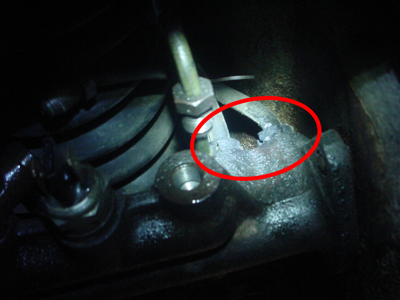

I am replacing the calipers on my car. After pumping the old fluid out, we realized the soft lines needed repair (they were fine before). Now, there is a link under the car that appears to be coming from the master cylinder:
The dark areas are wet with brake fluid.
Here is a closeup of the master cylinder. The dark areas are wet. The only spot that is not wet (yet) is the lighter area on the lower left:
I have checked the reservoir at the top and it is fine. The fluid is coming from somewhere down here.
Please advise!
Thanks!

914 RZ-1   I think I have a leak near the master brake cylinder   Mar 11 2023, 10:58 AM
Craigers17   Just to double check things, if you have carpet, I...   Mar 11 2023, 11:34 AM
914 RZ-1   Here's a view under the carpet. It's wet. ...   Mar 11 2023, 11:41 AM
brant   You need to pull the pedal board Then the rubber s...   Mar 11 2023, 11:42 AM
Craigers17   Based on that last picture, at a bare minimum, I d...   Mar 11 2023, 11:52 AM
Mikey914   1st, yank this out and clean up the fluid. I'd...   Mar 11 2023, 12:02 PM
914 RZ-1   1st, yank this out and clean up the fluid. I...   Mar 11 2023, 05:26 PM
930cabman   Time for a new Master Cylinder   Mar 11 2023, 02:45 PM
914 RZ-1   Yeah, I'm gonna clean this all up: pedal clust...   Mar 11 2023, 02:51 PM
bdstone914   Yeah, I'm gonna clean this all up: pedal clus...   Mar 11 2023, 03:38 PM
flyer86d   Replace the master cylinder. If your pedal cluster...   Mar 11 2023, 03:23 PM
troth   This was the result of a mc leak on my 911. I w...   Mar 11 2023, 03:26 PM

Garland   Don’t forget the MC washers! “914 World ...   Mar 11 2023, 07:41 PM
76-914   A nickel to a donut your MC is toast. It will be m...   Mar 11 2023, 07:51 PM
914 RZ-1   I got it off. I just needed to pull it out a littl...   Mar 11 2023, 08:46 PM
bkrantz   What I like to do, for removing and installing the...   Mar 11 2023, 09:09 PM
914 RZ-1   What I like to do, for removing and installing th...   Mar 11 2023, 09:42 PM
Mikey914   Sorry was working in the shop today. Sounds like y...   Mar 11 2023, 09:52 PM
914 RZ-1   Which hoses from the reservoir go where? I've ...   Mar 11 2023, 09:59 PM
Mikey914   Which hoses from the reservoir go where? I've...   Mar 12 2023, 12:40 AM
