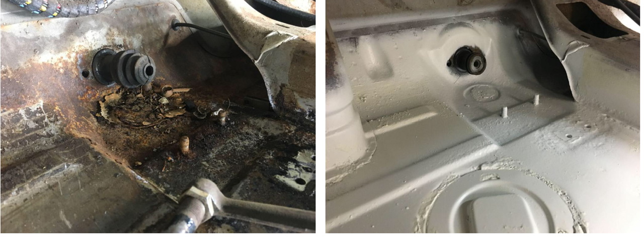

Don’t forget the MC washers!
“914 World post link”
Here’s my before and after
