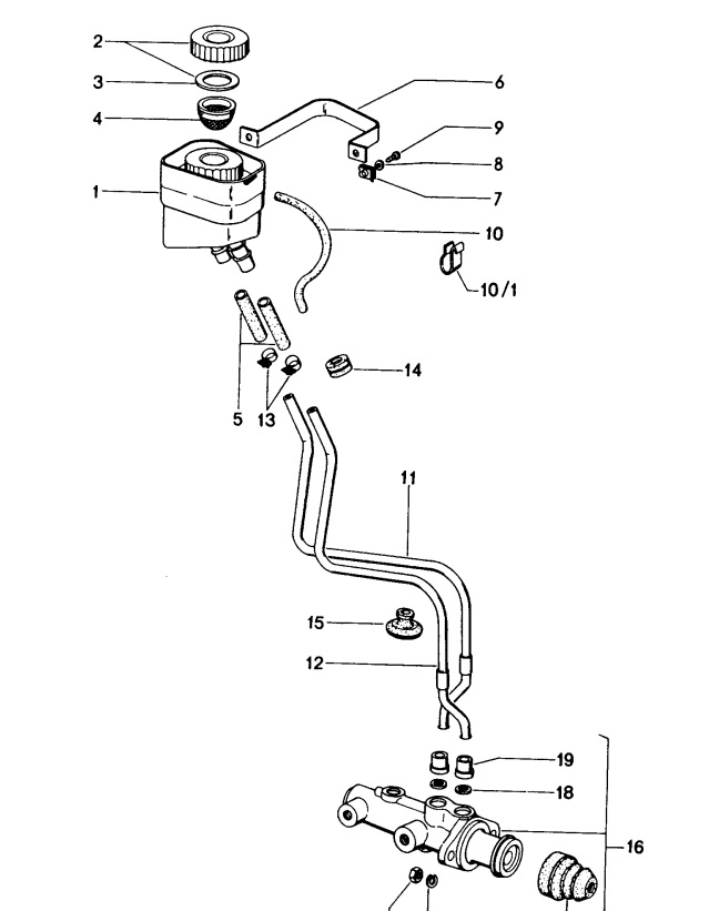

Which hoses from the reservoir go where? I've got the PET, and it looks like the one on the rear goes to the rear M/C hole and the one in the front goes to the front M/C hole, correct?
Mikey914
post Mar 12 2023, 12:40 AM
The rubber man
Posts: 12,772
Joined: 27-December 04
From: Hillsboro, OR
Member No.: 3,348
QUOTE(914 RZ-1 @ Mar 11 2023, 07:59 PM) *
Hope this helps. I will have to check as the orientation looks a little wonky

914 RZ-1   Which hoses from the reservoir go where? I've ...   Mar 11 2023, 09:59 PM
Mikey914   Which hoses from the reservoir go where? I've...   Mar 12 2023, 12:40 AM
