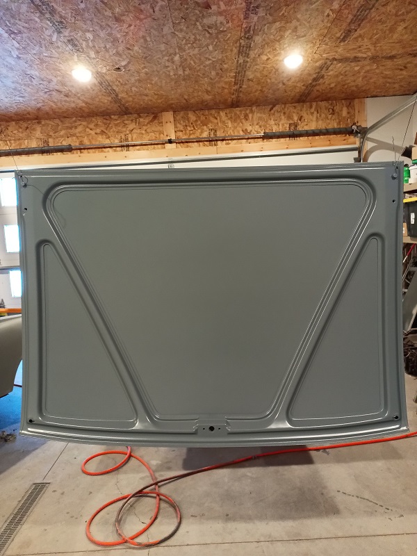

rick 918-S   Front lid is ready for block sanding. Picked the b...   Mar 15 2023, 11:26 AM
Daiberl   Incredible work, can't wait to get started to ...   Mar 15 2023, 11:47 AM
Root_Werks   Restorations that go this deep produce a better th...   Mar 15 2023, 03:08 PM

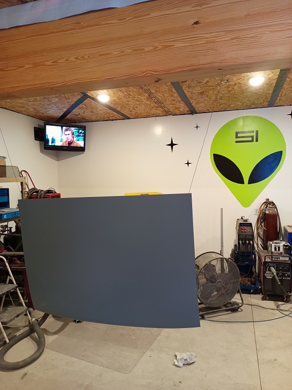

rick 918-S   The panels are blocked out and in what I believe w...   Mar 27 2023, 10:19 AM
rick 918-S   Epoxy White Sealer as a base under the color C...   May 10 2023, 03:43 AM
