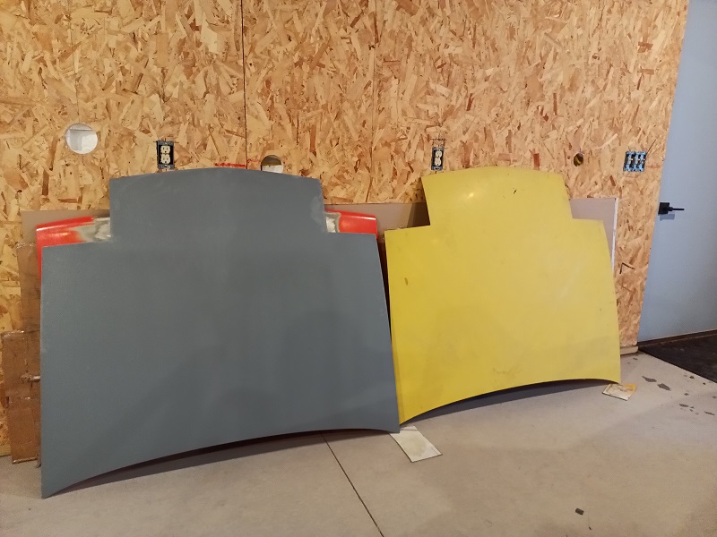

rick 918-S   Front lid is ready for block sanding. Picked the b...   Mar 15 2023, 11:26 AM
