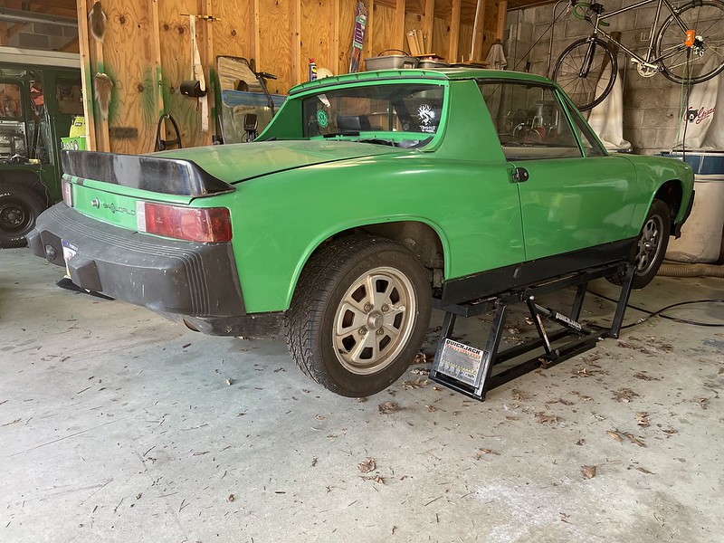

Last night I started working on unhooking all the stuff that connects the engine to the car.
(IMG:http://www.914world.com/bbs2/uploads_offsite/live.staticflickr.com-1435-1679067022.1.jpg)
914 went up on the quickjacks. I have a lift in the other bay, but as you can see my Westy is taking that spot right now for its re-wiring job. The quickjacks will work fine for this.
I took off the 1.8 airbox, and all the MS2 EFI stuff that had been attached to the engine bay of the car. The airbox and it supports came out and got shelved, but the EFI parts just got layed on top of the engine and will drop out with the engine.
My current engine uses stock fuel runners. Do they need to come out before I drop the engine? I don't recall if I put those on once the engine was in the car or not.

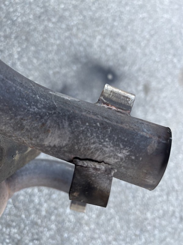

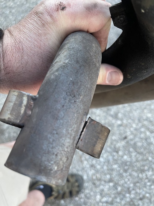

Under the car I only had time to pull the heat exchangers off. Some of you may remember my exhaust issues last year that ended up with me breaking an exhaust stud about 1mm into the head. Ahh, good times. After I fixed that, there was still an exhaust leak. I figured I had cracked the exchanger just inside the heater jacket (where they are super prone to cracks anyway. Well, I was partially right. I HAD cracked the exchanger, just not where I thought.
(IMG:http://www.914world.com/bbs2/uploads_offsite/live.staticflickr.com-1435-1679066960.2.jpg)
(IMG:http://www.914world.com/bbs2/uploads_offsite/live.staticflickr.com-1435-1679066960.3.jpg)
That was the same ear as the broken stud. I don't remember it looking like that when I put the heat exchanger back on last spring, but it had to have started there and probably opened up when I torqued the heat exchangers back onto to the car. Amusingly once the car warmed up that big crack would close up and the leak would become inaudible. I had damn near torn the entire ear off! But the cracked primary was small enough that it would close up when it got hot. I have a new (used good) set of SSIs to go on, but these might be work getting fixed.
