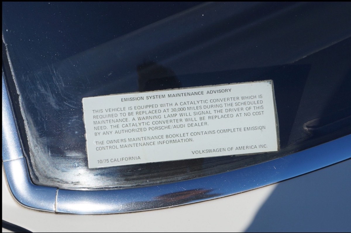

i'm not sure mr b. @JeffBowlsby has one of these in his collection of labels and plates on his website.
its the sticker specifically mentioned as a condition in CARB executive order for 76 model 914s. advises of cat replacement requirement at less 50,000 miles. only on 76 cal cars it seems?
manufacturers had to warranty all emission equipment for 5 years or 50,000 miles.
looks like VW/Porsche could not get them to last that long and this had been established before the end of the 1975 model long term testing?
