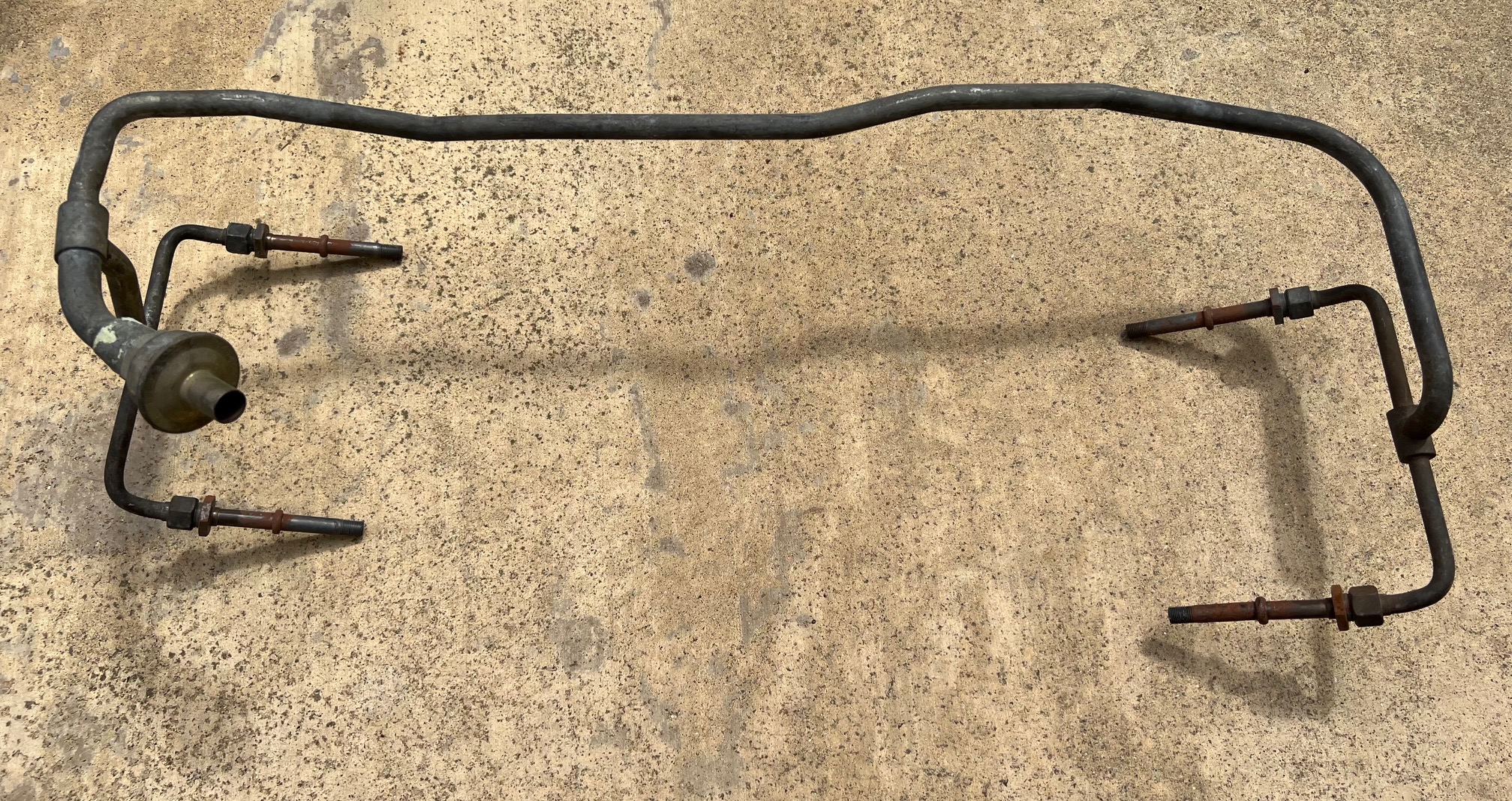

type47fan
post Mar 23 2023, 12:39 PM
It Looks Better In Person. . .
Posts: 860
Joined: 17-September 03
From: Carlsbad, CA
Member No.: 1,170
QUOTE(wonkipop @ Mar 22 2023, 04:11 PM) *
@gnomefabtech
a very tidy 76 is up on BAT at moment.
calif spec. with emissions equipment removed and no california smog cert.
the removed emissions equipment is going with the car in a box.
if it sells you might be able to get the buyer to sell it if they are taking the car out of calif?
looks like its got everything except the long pipe that connected the EGR to one of the rear mufflers.
https://bringatrailer.com/listing/1976-porsche-914-51/
He'll also need this assembly . . .
