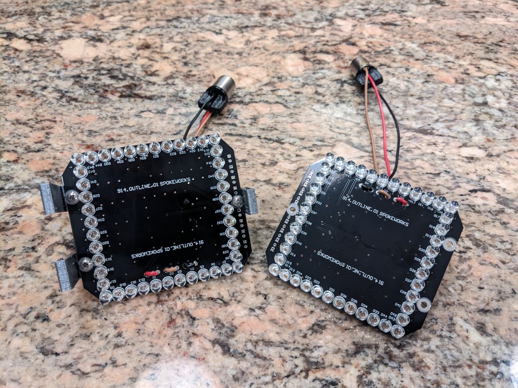

Not a 3rd brake light but something I designed last week. Not sure how it would look. Basically just an outline of LEDs. Many new vehicles use the LEDs in a pattern of some sort. Why not the 914?

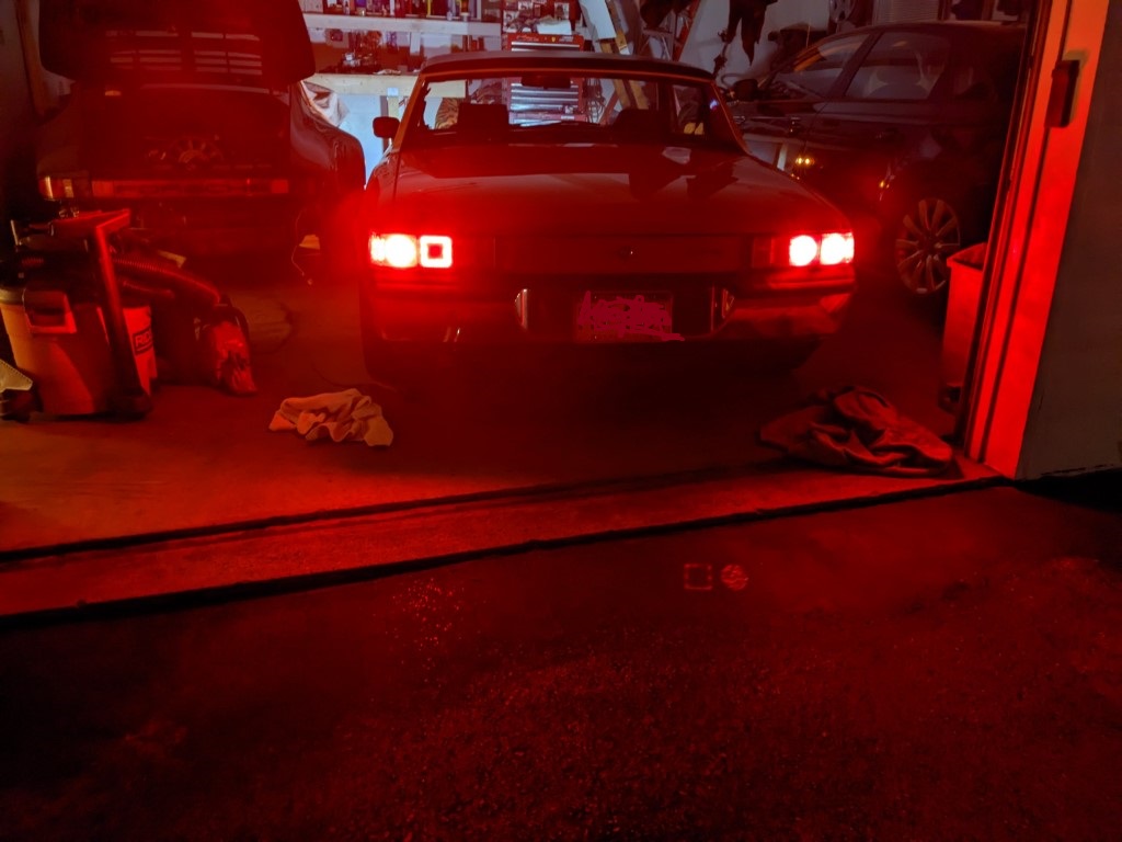

Trying out the new light.
Looks interesting with a round turnsignal and an outline brake.

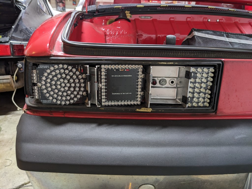

Spoke   The boards slide into the spacers. The boards...   Sep 1 2023, 08:08 PM
Spoke   All lit up. The 4 bulbs together burn 2.5A at 14V...   Sep 1 2023, 08:10 PM
