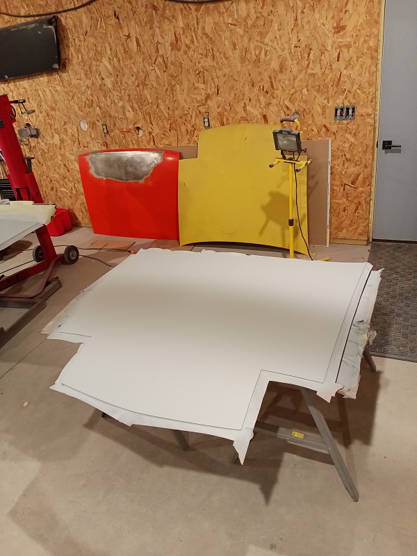

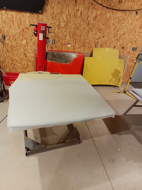

The panels are blocked out and in what I believe will be final primer before paint. Shot out some of the color from a pint I purchased to check the color. I have a hood from a 1970 that is supposed to be the same color. I need to polish a section to see how close it is before investing a boat load of cash on a large volume of paint.
