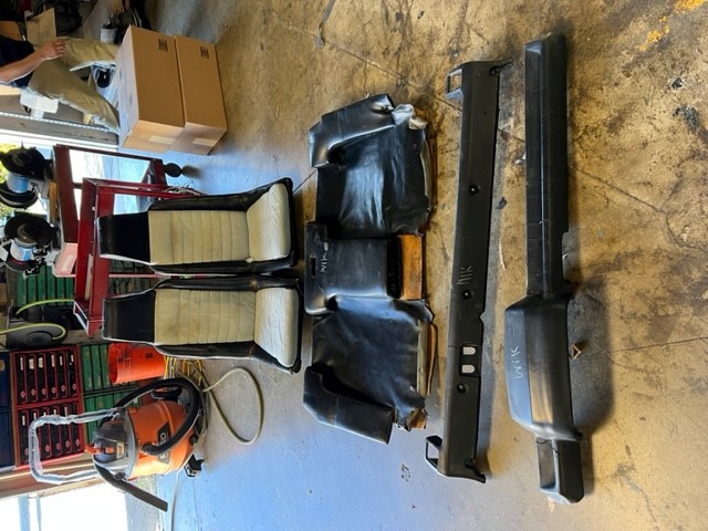

I was able to get my interior bits down to Autos International in SoCal. Initially, I had my buddy take just the seats, the dash upper and lower, and the rear pad behind the seats.
My friend John had some extra interior bits that he brought down to give to our interior guy and without me knowing. John offered to let me have them, and after thinking a bit more about it, I decided to use the targa pieces he brought down. There were two front targa pieces, the back and the two back side pieces.

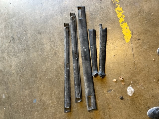

While the originals are still here in Vegas, I had only planned to reuse the side pieces as they were serviceable as is. I already purchased new front and back pieces from 914 rubber, so I thought I was done with those pieces.
After looking at the 914 bits, they are OK, but I thought it would be better to have all the interior bits recovered with the same material from the same place.
That's going to be a nuts bill when it comes up, but the Targa interior pieces are so important. They need to look great and feel great and they are high visibility for the project. I want it all to match too. It would have been a shame to put nice seats and dash in and have it not match.

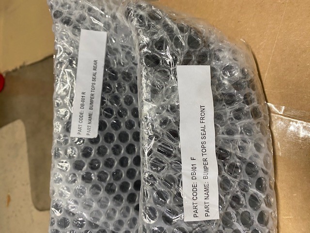

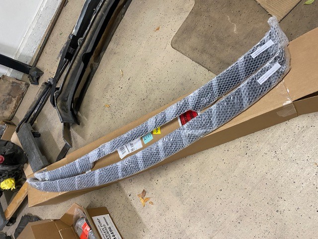

Speaking of rubber, I picked up AA new front and back bumper tops.
They teased a sale a few weeks ago and I jumped on it. I haven't unwrapped them, but they hyped them as being great quality reproductions.

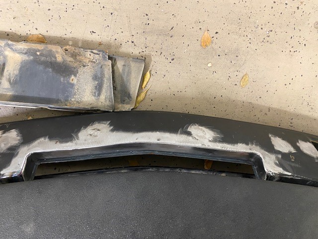

Now my backdate parts list is complete. I have the front valance lower which I will modify for the GT cooler opening to match the bumper.

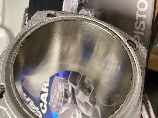

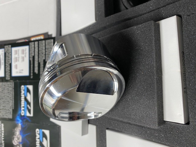

Here's the 10.3:1 CP Pistons and Mahle jugs I got for a song.
I'll have about 17K in the motor in parts including the Webers I picked up. That's not too bad knowing the astronomical cost of air cooled Porsche flat 6 motors. It will take another couple thousand to get it finished up, but I think I'll have a fresh 2.7 for about 25k in the end. That's very very reasonable these days. Of course this is me doing the full teardown, rebuild, and tune.
