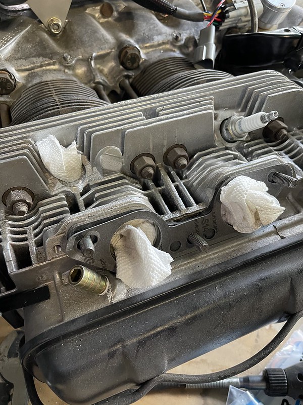

  • Cut a channel in the right side heads for CHT.

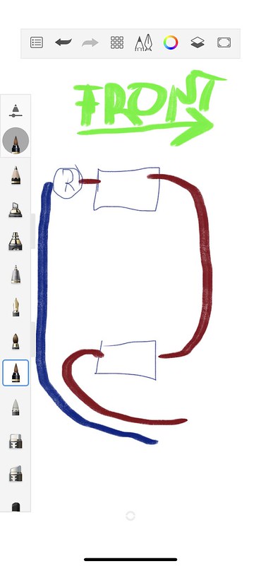

This is the new fuel hos routing. A little bit of a change from what PMB had designed but after checking with the designer the would make it easier to connect the fuel lines to the car.

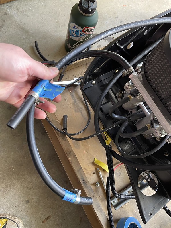

Both hoses now exist where the need to connect to the chassis fuel hard lines. Red is regulated, blue is return.

partial engine teardown to get to the heads so I could CAREFULLY grind in a groove for the CHT to lay in.

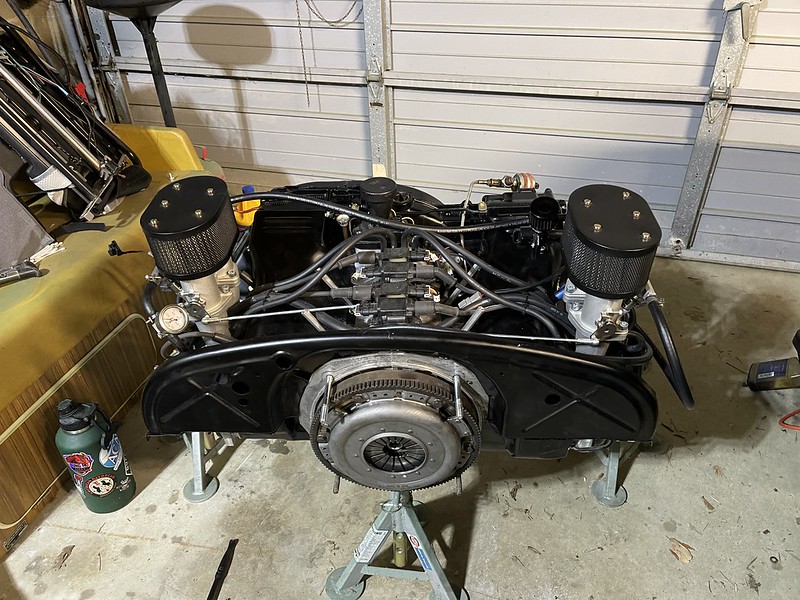

Engine is off the pallet on jackstands. Clutch kit is on. Engine is mostly back together (the shroud is missing). This is where I stopped Saturday night. It was a full day, and I got a lot done!
