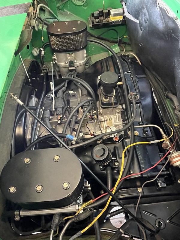

About 18ish months ago I bought into a new engine program Eric and PMB were starting up. If you have seen me in person I've probably talked your ear off about it. Sorry about that, I've been pretty excited.
Mine is No2 off their line, and its crated up in Utah waiting for the shipper to pick it up.
So its really real time here in Dallastown, and I've started getting my 2056 ready to come out.
The new engine!

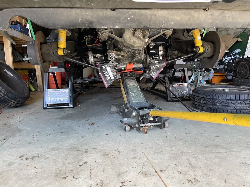

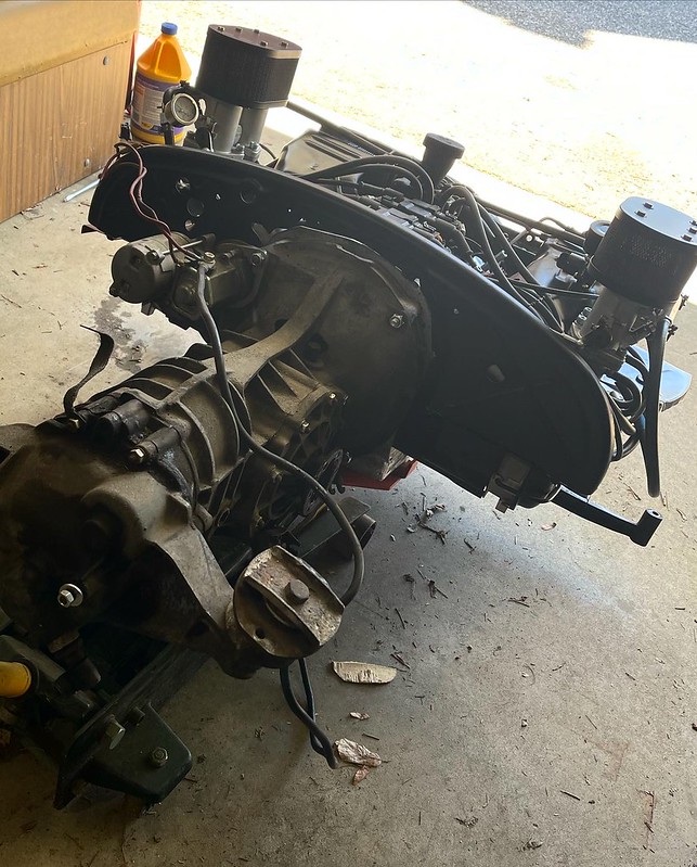

Today was a shorter day. Took the GF out to brunch, and did not touch the engine till about noon. Had to start getting cleaned up to go get my kids at 4. I made the most of the time.
(IMG:http://www.914world.com/bbs2/uploads_offsite/live.staticflickr.com-1435-1680490756.1.jpg)
Engine and transmission got a little getting to know you time. Also the engine came off the jackstands and on to the jack and lifting plate.
Put the Ford solenoid on the rear engine tin.
And then it was time to get the new engine into the car.

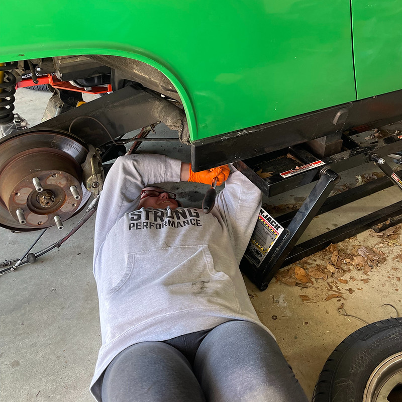

I got brunch and she helped getting the engine bolted into place. Winning!
(IMG:http://www.914world.com/bbs2/uploads_offsite/live.staticflickr.com-1435-1680490757.4.jpg)
There it is! All snugged up into place.
