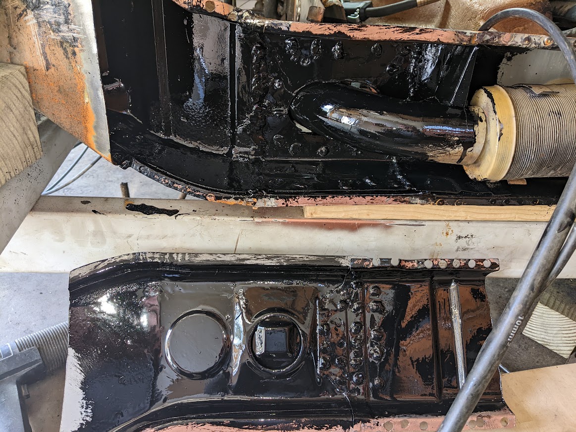

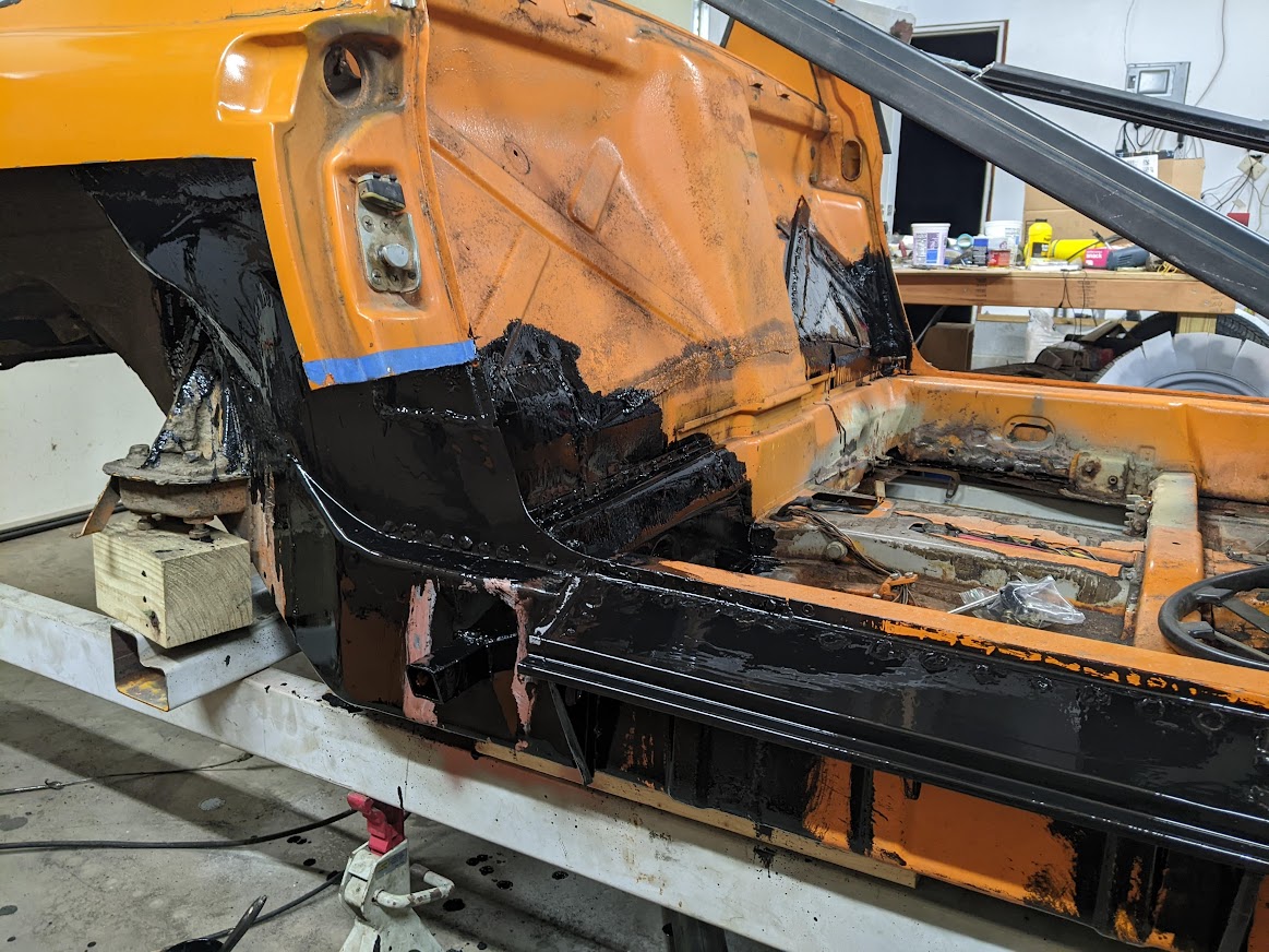

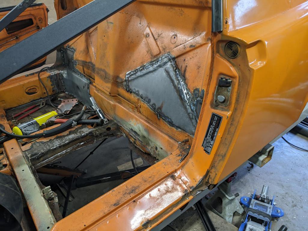

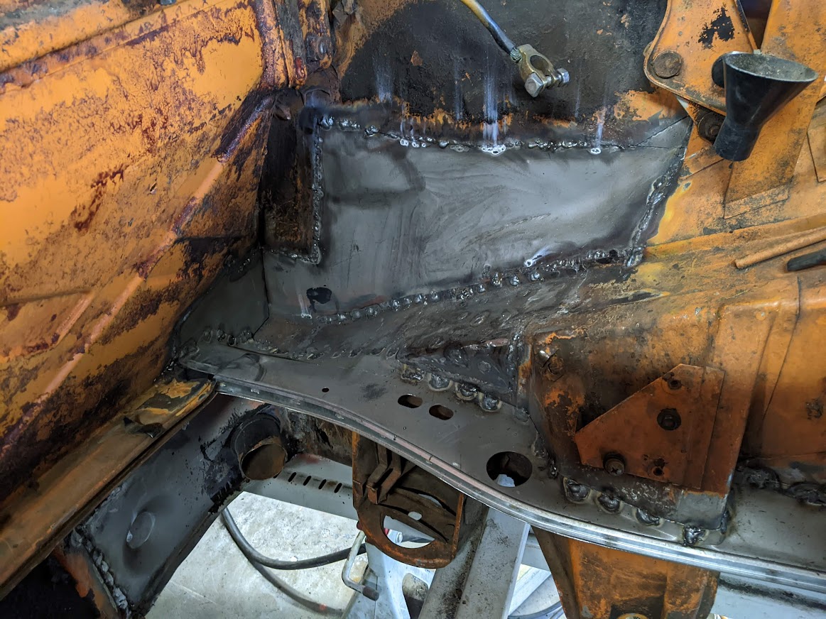

Time for some updates.
I por-15 'd the inside of the long
I got the hellhole patched up.
And the back firewall.
por-15 the outside

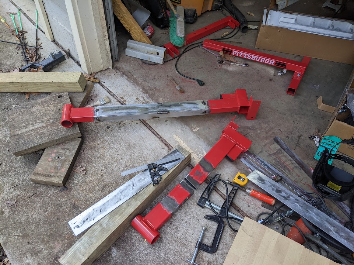

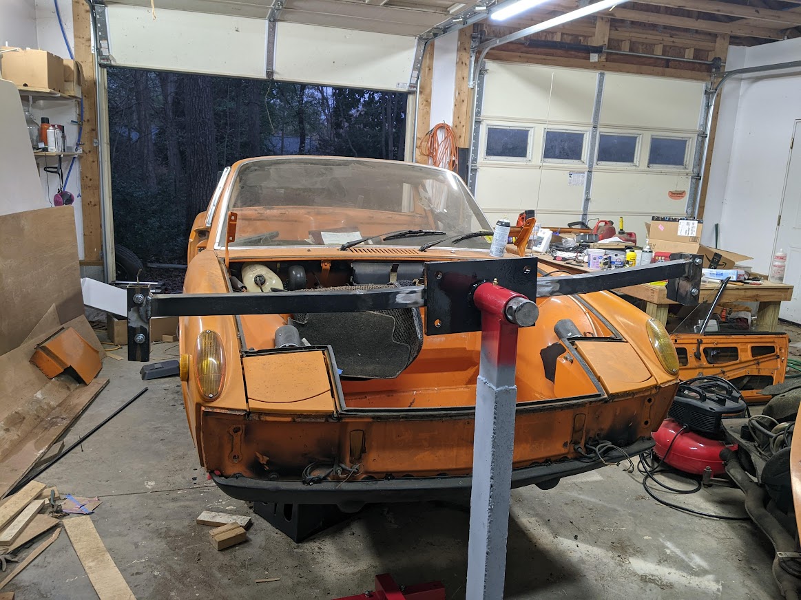

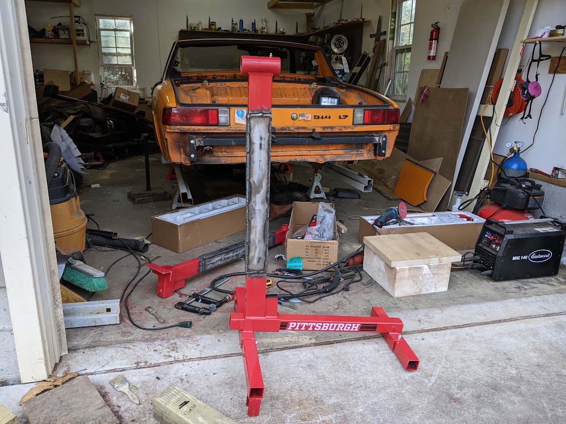

Then went with the HF engine stand, which I lengthened
Looks to be straight if I don't put the wheels on. Otherwise would sit back at an angle.
Now how do I get it up there?

QUOTE(stoneman30hotmail @ Mar 30 2023, 05:18 PM) *
I hope you removed the surface rust and prepped the metal per the instructions before applying all of that POR15. Otherwise you're just covering up the problem rather than fixing it.
Great to see you're still moving forward. (IMG:style_emoticons/default/beer.gif) Keep posting pics of the process.

QUOTE(rjames @ Mar 31 2023, 12:36 PM) *
Yep the prep is where the magic happens.
