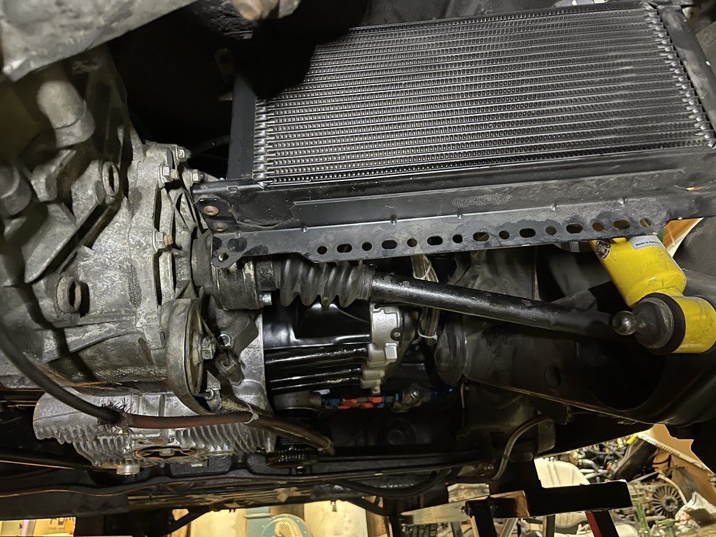

Oil cooler back in place minus the fan packs. The fans draw a lot of power, and I'm not super sure I even need them. I just don't find myself sitting in traffic for long periods of time in this car. In fact, I do my best to avoid that! This is the same place the cooler has been mounted for the past decade or so, and it has worked. I know front mount is better, but I need the trunk space! This pick also shows the sandwich mount and the hoses routing along the valve covers.

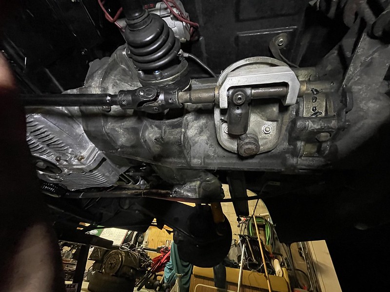

Chris's improved shifter console. The whole kit is so much better then stock IMO. Cover is on it now so you can't see it. Just looks stock except for the little tail sticking out the back.

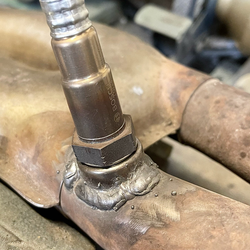

The 02 bung welded in. I don't TIG. I used my little Lincoln 140 set up in Flux Core mode. Local welding supply shop recommended I try this Flux Core SS wire instead of buying SS MIG wire and a new bottle of gas. It needed a lot of heat to lay in, and I did some practice repairing my cracked set of SSIs before I got the good set out and started cutting a hole in them. Not nearly as pretty as TIG, but it works - well even.

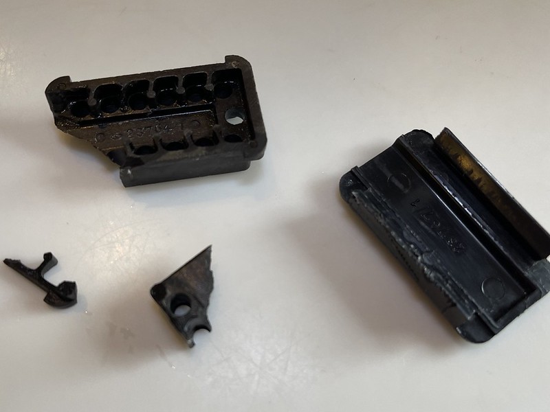

I needed to add a wire to the 12 pin plug. When I took the plug out of the slot on the relay board it crumbled in my hands! Fuuuuuuuuck!
So I called Tony at Translog and Steve at Aircooled Racing to see if either of them has one I could scavenge off a trashed harness. Left a message for Tony, and he will get back to me.
Steve said he was pretty sure he had one, but was running out the door to go see a 97 year old friend who was not in great shape, and that's way more important then a plug off an old car. I'll give him a buzz Monday and drive over if Tony does not have one today. Its been a minute since I drove to Steve's shop, so I'm leaning towards that option just to go and see what he's up to these days.
I'm REALLY close to first start.
Need to get the SSI's in, hook up the fuel line (I'll likely do that today) and fix the relay board wire harness.
Also I want to pull the ECU board back out of the car and modify it slightly. As is, the firewall pad won't fit without putting some pressure on the ECU board. But if I am able to move on of the relays, the pad will fit a lot better. I'm using the 914Rubber pad that does not hold water against the firewall, and it blocks a lot of noise from coming into the cabin.
