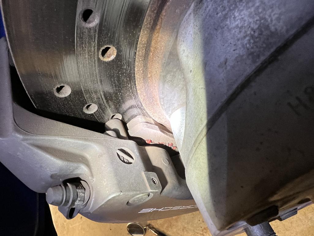

My caliper pins are rubbing on my rotor and I hope to get some advice from this group. The car is a ‘70 914/6 (factory) that was restored as a GT tribute about 15 years ago.
It is running 1st gen Boxster calipers (986-351-421) on a 911 strut (911-341-041) with a misaligned rotor, The rotor is unknown, but is 24mm thick, 11” diameter and is not centered in the caliper. It looks like I might have the wrong rotor on this set up. The questions at this point are:
1. where is this strut from
2. is the Boxster caliper an okay fit (seems spot on from what I’ve read).
3. What rotor should I be running; and
4. what modification are needed to fix the misalignment? The Caliper needs to move .06” (1.5 mm) outward so the rotor will be centered between the pins. I can’t see how one could shim the calipers in the correct direction.
Pictures to follow…

davenorcal   My caliper pins are rubbing on my rotor and I hope...   Apr 18 2023, 11:24 PM
davenorcal   The picture above is a view of the outer side. Th...   Apr 18 2023, 11:27 PM
SirAndy   @davenorcal From my first post in this thread: ...   Apr 19 2023, 12:19 AM
