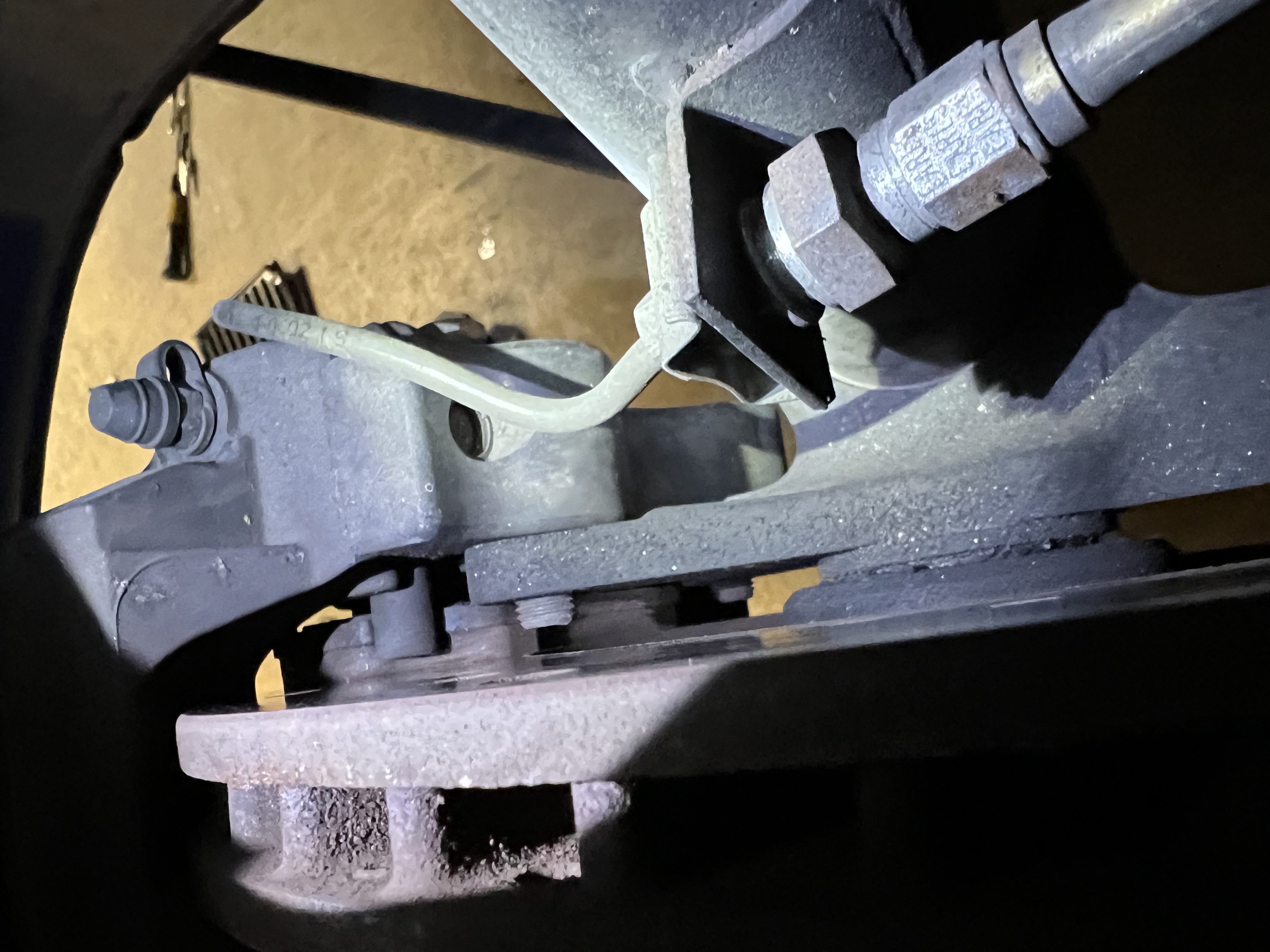

davenorcal   My caliper pins are rubbing on my rotor and I hope...   Apr 18 2023, 11:24 PM
davenorcal   The picture above is a view of the outer side. Th...   Apr 18 2023, 11:27 PM
SirAndy   @davenorcal From my first post in this thread: ...   Apr 19 2023, 12:19 AM
davenorcal   @[url=http://www.914world.com/bbs2/index.php?show...   Apr 20 2023, 12:30 AM
SirAndy   @[url=http://www.914world.com/bbs2/index.php?sho...   Apr 20 2023, 09:29 AM
burton73   [quote name='davenorcal' post='3072547' date='Apr...   Apr 20 2023, 11:27 AM
davenorcal   @sirandy - Dang, you are so right. I took pics o...   Apr 20 2023, 09:42 PM
