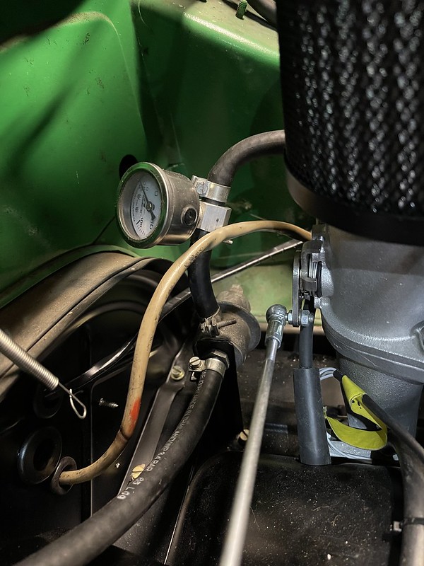

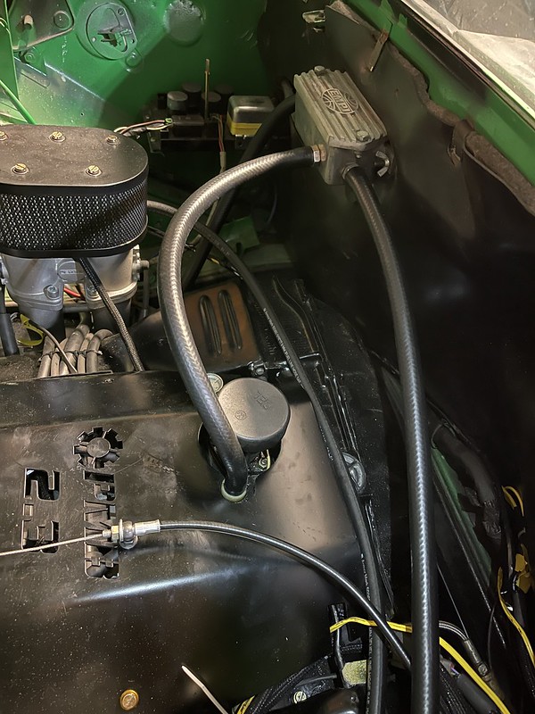

So close but no cigar tonight. (IMG:style_emoticons/default/headbang.gif)
(IMG:http://www.914world.com/bbs2/uploads_offsite/live.staticflickr.com-1435-1681957691.1.jpg)
Got the breather hoses into place. Had to scrounge for a nut, but only found a wingnut. That will work.
Cranked over the engine with no fuel to build oil pressure. But that was going to take a minute and I did not want to wear down my battery. So after making sure I did not have any oil leaks, I added gas to the tank and let the pump build pressure.
(IMG:http://www.914world.com/bbs2/uploads_offsite/live.staticflickr.com-1435-1681957691.2.jpg)
But there was no fuel pressure. Despite the fact that I heard the pump freewheel, then labor. So I turned the key off, and let it go through the prime cycle again. This time I was getting bubbles in the tank letting me know excess fuel was going down the return line. Still no pressure at the gauge.
So, I have the feed and return lines miss-plumbed. Which actually means I have the feed and return lines wrong under the tank. Fuck that, I'll fix it in the engine bay.
I also found that I have a slight weep coming from what is supposed to be the return line (but which is currently the feed line). I need to undo those hoses and switch them anyway. I'm tired, and I need to let fuel pressure bleed away anyway. So this will be a tomorrow job - IF I have time tomorrow. I'm a little grumpy about this. I was pretty damn sure I'd be posting a first start video tonight. But that's okay.

VaccaRabite   So close but no cigar tonight. :headbang: http:...   Apr 19 2023, 08:28 PM
VaccaRabite   Thinking about this with a clearer head this morni...   Apr 20 2023, 06:04 AM
