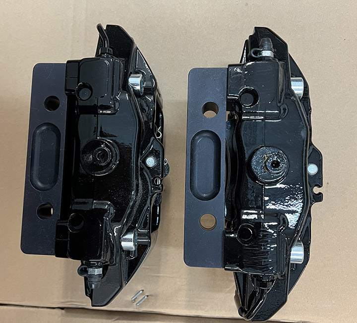

@sirandy - Thank you. I read that and I could not visualize how inserting an adapter solved my problem. It looked to me I needed to shave 1.5mm off the face of the caliper where it seats to the flange of the strut for the caliper to go in the needed direction. Clearly, I’m missing something.
Please send pics of the back side so I might see the configuration, if possible. Thanks again!

@davenorcal
You already have the adapters mounted to your calipers. I can clearly see them in your pictures.
I milled down the adapters so the calipers end up centered on the 24mm rotors.
And as mentioned, i also shaved down the pins.
PS: Yours don't appear to be the Rich's adapters, unless he has a new design. But it can't hurt to contact him anyways.

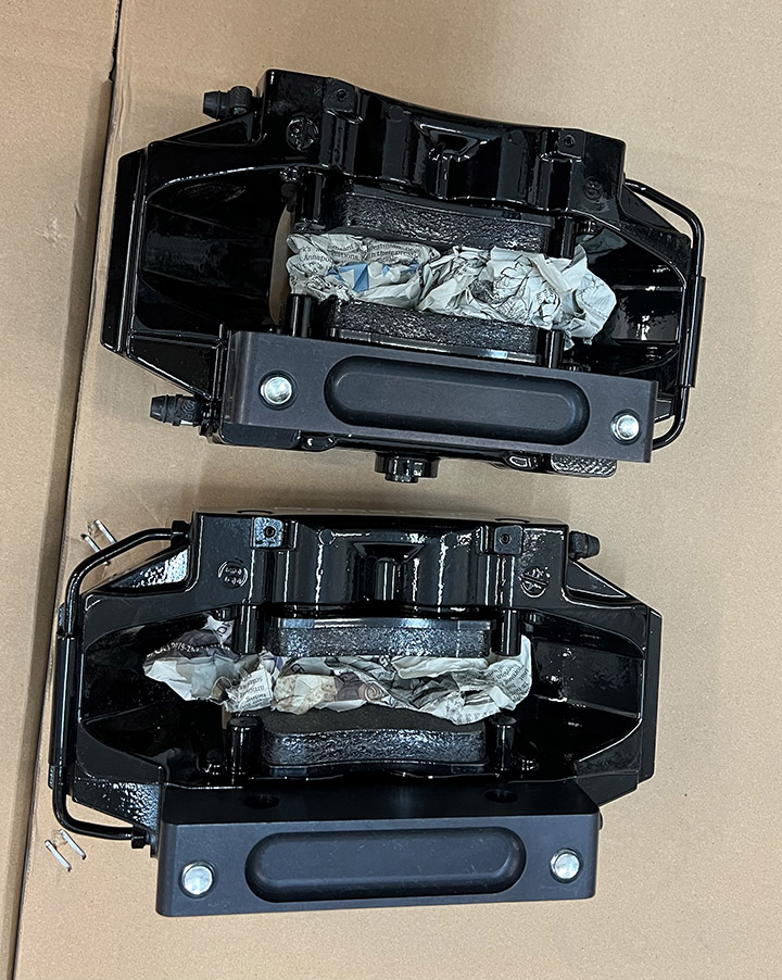

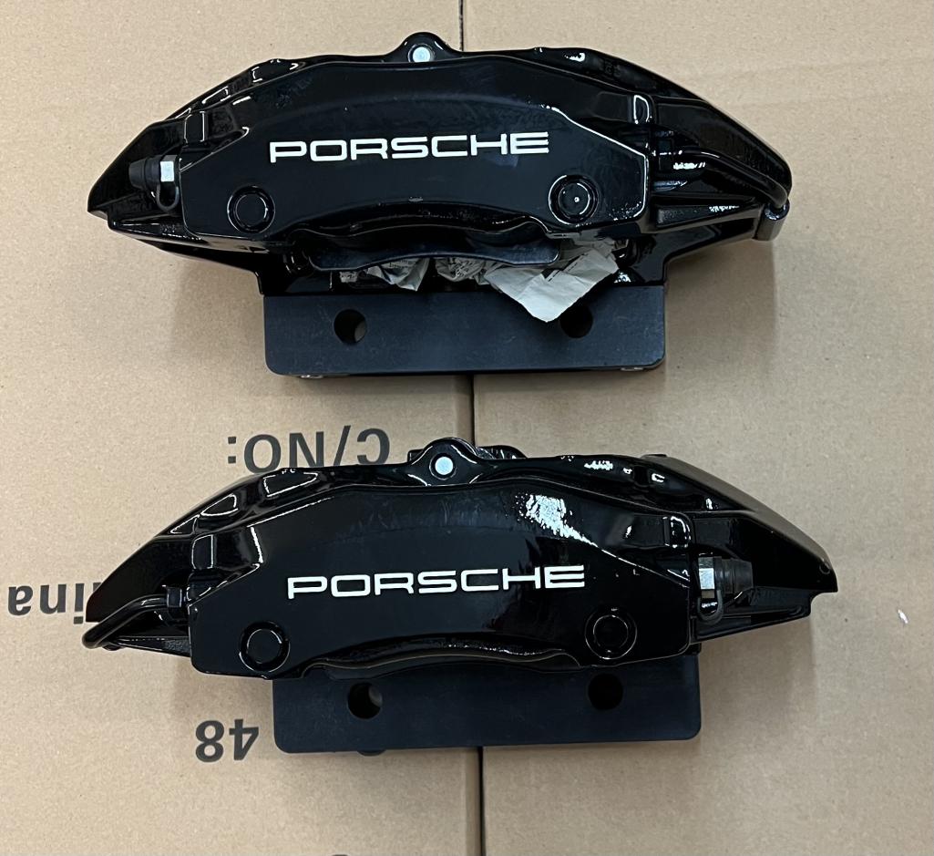

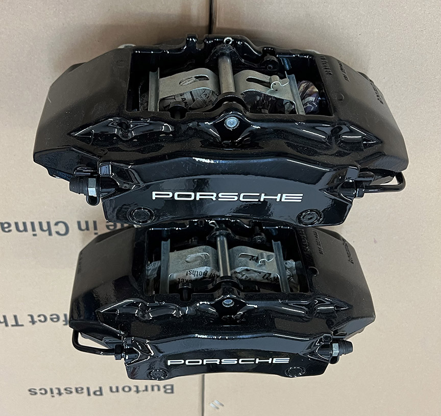

Hi Guys,
I happen to have a set of Boxster NON S calipers rebuilt by Rick several years ago with his adapters set to go on my 85 carrera front end with Elephant Polly Bronz.
Just so you guys can see what these boys look like.
Best Bob B
